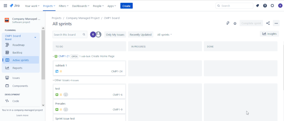

hi @Keisha Cooper
If you are have multiple active sprints (parallel sprints), it's normal that you see a greyed-out button.
If this is the case for you, please consider filtering to the desired sprint and the button will be enabled (check the illustration below)
Let me know how it went for you
Cheers,
Karim
