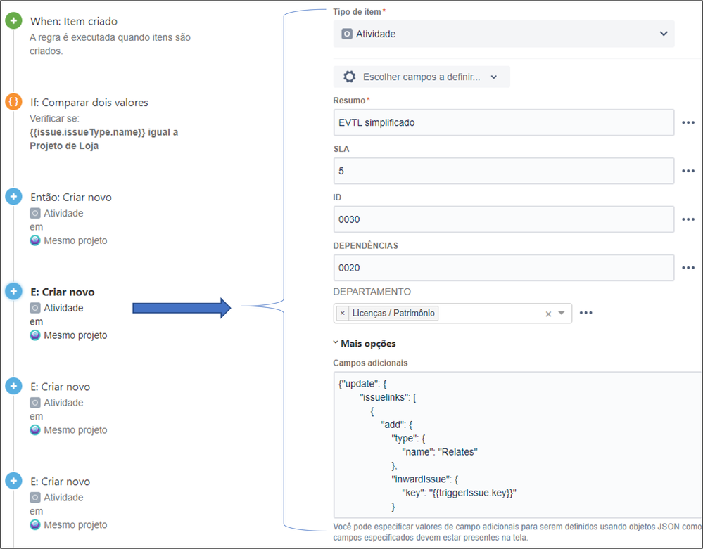

From the very beginning, I'm trying to create an issue template with automation, where there'll be a hierarchy with a main parent issue and several child issues (I'm linking them to the parent both using the native parent-link field and relating them so I can go through them with smart values). So the firs part of the automation, which is ok, is having the trigger upon the creation of the parente issue, then creating each of the child issues (they'll have different summaries and other information on specific fields), here is an example:
The custom field "ID" (customfield_10600) is where I'll set a specific id for the issue, and the custom field "Dependências" (customfield_10601) is where I'll tell which issue ID the issue should be linked to. I chose to refer to the child issues with an ID, since issue keys wouldn't work for this case, and summary is more susceptible to changes.

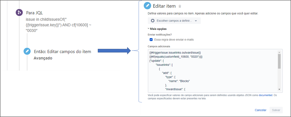

After creating all the child issues, I need to set the links between specific child issues, that will work kind like dependencies, so I can later set and change dates automatically based on theses links. One option would be filtering each child issue in different branches, and instead of referring to the custom field "DEPENDÊNCIAS", I would just compare the ID of all issues related to the trigger to a given ID, and get that issue's ID to create the link, like this (the additional fields has the same script structure I sent earlier) :
That's what I have so far, and it works, but I need to repeat it as a branch for each child issue. Rather than doing this, I thought it would be possible to create a single branch for all the related issues (child issues), and then again, with the smart values/json script, going through all the related issues to check the custom field "ID" and see if it matches the custom field "DEPENDÊNCIAS" of the branch issue.
