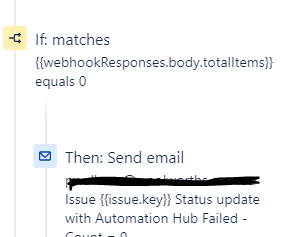

I am trying to create an Automation that performs an action, based on the value of a field within the {{webhookResponses.body}}

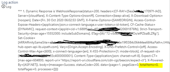

My requirement is to perform an action based on the totalItems field in the body field of the response, which can be see here
I can access the field successfully, as shown by the following, which is displayed in Audit Trail by the Log command
But when I try an "if" statement, it doesnt seem to work
Any clues/tips on what I am doing wrong with this would be appreciated

Phil Walburn
October 30, 2020
Hi @Nir Haimov

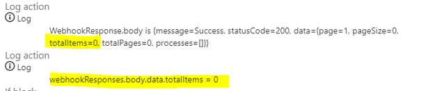

yes, I have Logges the totalitems, and confirmed that it prints 0
here are a clearer examples of the log
thanks

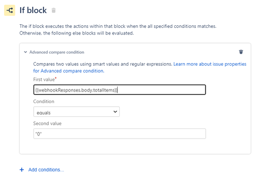

@Nir Haimov , Im not clear on how to incorporate that into an IF Block with the Jira Automation function
Is this what you meant ?
(it didnt work)

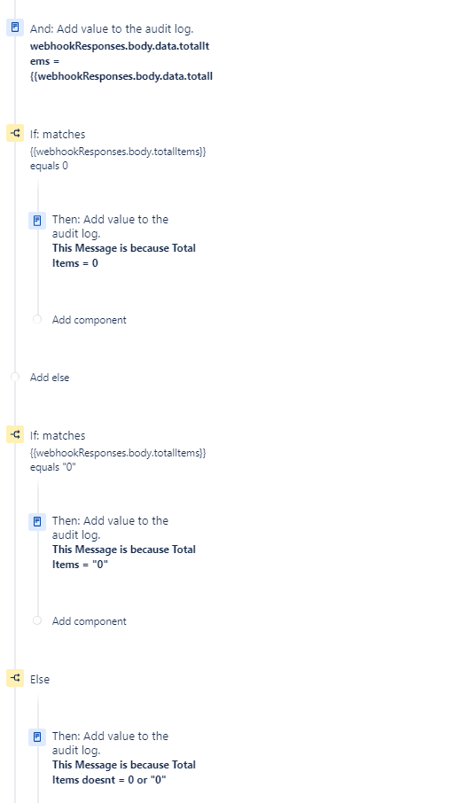

Here is an exampled of my code
So, as you can see, I Log the field value, and then I have and IF Statement to check the field, using quotes, and no quotes, and then and ELSE Statement to catch it, if it falls through

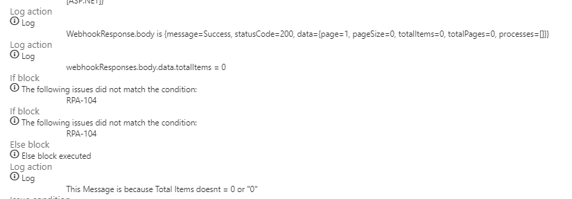

Below is the Log after execution
As you can see, it Logs the field value (0), then doesnt match the 2 IF Statements, and executes the ELSE Statement
