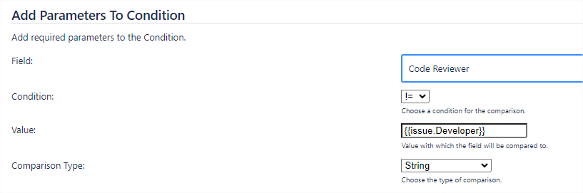

Hello, during a transition I would like to be able to test that 2 fields in the issue containing a user name are not identical. I did not find in the possibilities proposed in the conditions, validators or post functions.
I found a possibility to check a constant value for a field but not a comparaison between two fields values of the current issue like it's possible with the IF object in a rule for example.
What I want to do :
Thanks a lot per advance for your help.

Hi @Gregory BENARD
This isn't possible using native Workflow functionality; you're going to need an App to do this type of comparison - some options include...
You could use Automation as an alternative? You could...
  • Create a custom field - eg. a checkbox field called "Users Match?"
  • Populate it using Automation; the rule could activate when either Code Reviewer or Developer is updated, check if they match - and update the field to "Yes" if they do
  • Use the "Users Match?" field in your validator instead, which would be possible without an App
Let us know if this sounds of interest; happy to provide more detailed setup instructions if needed :)

Ryan M
November 23, 2023
Hey Gregory - A couple options come to mind off the top of my head.
  1. There are third party apps, like ScriptRunner for example, where you can create Scripted fields and be used to check to values of the two other fields and populate a boolean (true/false) output for that field based on that comparison - you could then use the value of that custom scripted field with the standard transition tools. This would have the benefit of not using up any automation runs.
  2. You could automate the population of a custom boolean field every time a ticket is edited/created using the built in Jira Automation platform. Benefits - it's included with Jira, downfalls could be potentially using a lot of rule runs/performance depending on how this gets used.
I also see that you're using a condition for this transition. You may already be aware, but just to confirm, a condition would evaluate the condition during page load (before the transition) and HIDE the transition if it is not met already, potentially confusing end users. This would not technically check "during a transition" as you said you were attempting above, but instead prevent the transition from being possible at all - people would not see the option to use that transition at all, and would not be provided any info on why the transition wasn't there.
A validator would run during the transitions execution and produce an error if the validation isn't passed. Personally I think a validator makes more sense most of the time, but that's up to you to decide what's right for your org.
Hope this helps or gets the wheels turning towards a solution!
