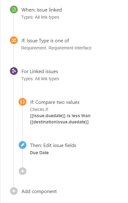

Thank you for your response! Of course, this is our automation right now:Screenshot 2023-11-02 174208.png

Which issue(s) are you trying to edit for the due date: the trigger issue or each linked issue?
GGS
November 3, 2023
We want to edit the issues with Issue Type Requirement or Requirement interface when an issue is linked to them in case the due date of the other issue is furthest.
Bill Sheboy
November 3, 2023
In that case, the edit cannot be inside of the branch as it will edit the linked issue.  And so your rule will need another approach to find the latest due date...

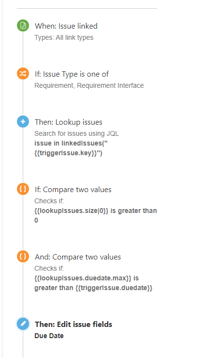

In that case, please consider updating your rule like this...
  • trigger: issue linked
  • condition: issue type is Requirement or Requirement Interface
  • action: lookup issues, with JQL for the issues linked to the trigger issue
  • advanced compare condition: check if the lookup returned any issues
    • first value: {{lookupIssues.size|0}}
    • condition: greater than
    • second value: 0
  • advanced compare condition: check if any linked issues due date are after the trigger issue
    • first value: {{lookupIssues.duedate.max}}
    • second value: {{triggerIssue.duedate}}
  • edit issue: set the due date toe {{lookupIssues.duedate.max}}

As always, thank you very much for your answer. This is what we have done:

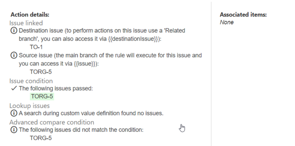

But JIRA does not recognize the linked issue as one with greater duedate

That audit log shows the Lookup Issues action found no issues for the JQL or that the field was not found.
I wonder if the Due Date is supported yet for Lookup Issues with Jira Server / Data Center.  When that action was first added for Jira Cloud, only a few fields were supported; later Atlassian added the remainder of them about a year later.
The check for this is to write this to the audit log after the Lookup Issues action:
If the field is not present, another approach will be needed.
GGS
November 16, 2023
Thank you very much for your help Bill. Apparently it was a problem with a custom field with the same name u.u
Thank you it works now!
