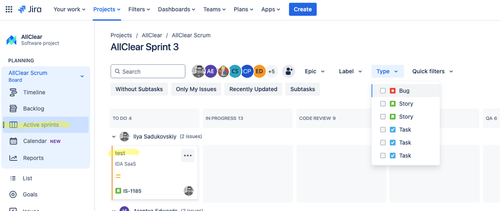

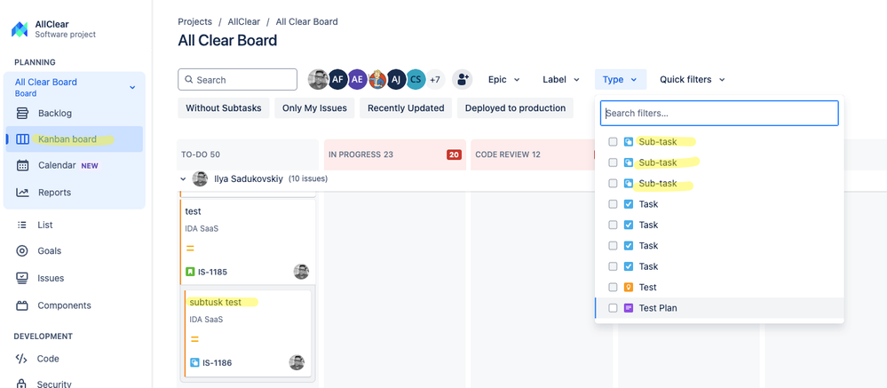

We are using company managed project
While I am able to see subtasks on Kanban board
But I am not able to see the sub-tasks on the sprint board. You can also notice that Type filter does not have Sub-task listed. Both boards are using the same saved filter that has this query: `project in ('project1', 'project2', 'project3' ) ORDER BY Rank ASC`
We are switching from Kanban to Sprint and would like to continue to see the sub-tasks on the board. Help appreciated.

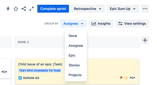

From the screenshot, can you confirm that your board is grouped by Assignee?

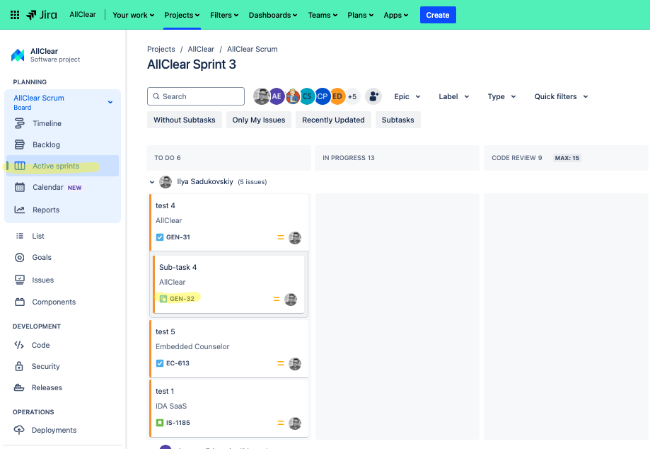

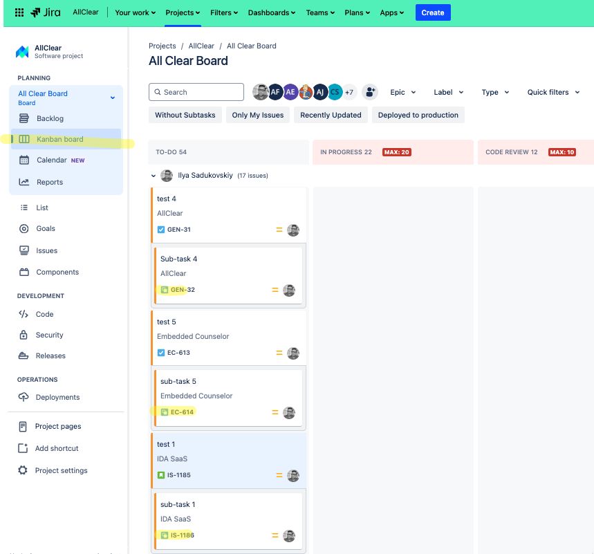

Ilya Sadukovskiy
July 23, 2024
@Dave Mathijs thanks for your prompt response. Yes, the board is grouped by Assignee.
I created this company-managed project (GEN) so I can create a combined board where I can see 3 other team-managed projects (IS, EC, VIC1). They are all active projects and have their own Kanban boards which do not show sub-tasks even when I turn on Sprints.
I tried creating a task with a sub-task in GEN (AllClear project you see) and it does show it as expected. So it appears that the team-managed sub-tasks are the issue here, but how come they are showing on a Kanban board just fine.
Ilya Sadukovskiy
July 23, 2024
Appears to be a known bug :( https://jira.atlassian.com/browse/JSWCLOUD-26933

Trudy P Claspill
July 22, 2024
Hello @Ilya Sadukovskiy
For the sprint that you are currently showing in the Scrum board, do any of the issues within that sprint actually have subtasks? The Type filter will show only the issue types that are contained in the current sprint. If none of the issues in the current sprint include subtasks, then that will not be an option under the Type filter.
Ilya Sadukovskiy
July 22, 2024
Yes, same ticket number IS-1185 of a task with a subtask is shown on both boards.
