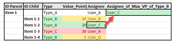

Hello,
I am a newbie in Community and struggling with the following challenge:
I managed to get the max value points of items of "Type_B" onto the top level of this structure (using max#subtree {condition}). But I am struggling with getting the assignee (or any other field) into the top line, that is assigned to a descendant item of "Type_B" with the highest value points (20 in the example).
The example is a bit simplified as there are more levels with parent child links possible in my "real" challenge.
Any suggestions how to takle this. My appreciations in advance!
Georg

Georg Bauser
November 10, 2023
Hi @Bill Sheboy ,
Iam using Jira v9.4.11 + ALM Structure
My question is related to ALM Structure. Is this wrong community?
Regards
Georg

Stepan Kholodov
November 10, 2023
Hello @Georg Bauser
If all issues are present in the structure and they are added in a form of a hierarchy, then you can extract min and max values of descendants and show them at the highest Type A issue with a formula like this:
if issuetype = "type A": max{if issuetype != "type B" and issuetype != "type C": assignee}
the approach here is to define the issues under Type B, so the formula would only consider their values. If such issues are of a different issue type, then you can just define this type; or if they have any other unique afield value, it can be used as well.

Georg Bauser
November 10, 2023
Hello @Stepan Kholodov ,
Thanks for your suggestions:
I think that your formula would return in my example "User_D".
I am not looking for the Assignee with the highest Value if you sort all assignee names.
What I want is:
In a line of JIRA "Type A" return the Assignee of the JIRA Items of "Type_B" that has the highest "Value Points" (=20 )".
Do you have a further suggestion? I would appreciate it a lot!
Truly kind Regards
Georg
Stepan Kholodov
November 10, 2023
I'm afraid there isn't enough details about your setup to recommend anything specific - a right formula is often fitted for the structure where it's used. Please reach out to our support portal and we'll have a deeper look into your use-case.
