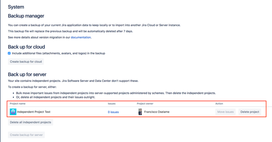

I'm looking to merge 2 cloud instances & in order to do that I have to create Server backups from the Cloud instances. Independent projects are not supported in Server, hence I need to know if any have been created so their issues can be moved into server-supported projects.

Unfortunately, these projects aren't listed as 'Independent Projects' when you go to the Project List of your instance.
However, when you go to the 'Backup Manager' page of your instance, in the 'Backup for Server' section, if you have any Independent Project on your instance, the project will be listed there as well as its now and how many issues are in that project, like in the screenshot below:
You can also see that there are options to either move the issues to another project or to delete these Independent Projects. Once you've deleted all of them, the Backup for Server option than become available.
Can you please try that and let me know if that works for you?

Thanks Francisco
The screenshot is very helpful ;)
