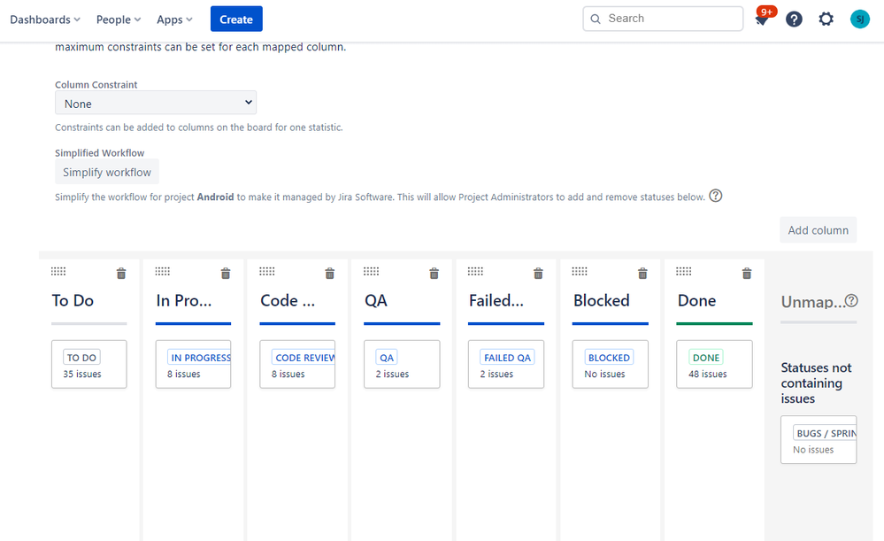

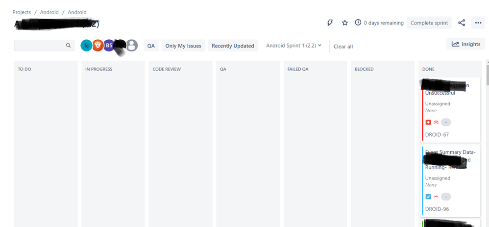

Hello,
I searched and searched and I can not find the answer for my situation.
When I go to Complete a Sprint, I get the popup and it says 35 issues were done, 17 issues were complete. But all of my issues are in Done.
1. My far RIGHT column in Column management is Done.
2. My Done status is mapped to my Done Column
3. Reports-> Sprint Report shows 33 issues in "Completed Issues"
4. Issue Navigator shows 33 issues in the Sprint all Status of "Done"
5. Physically counting the issues on the Sprint board is 33, all in "Done"
6. 33 issues listed in the Backlog for the Sprint.
No clue how the Complete a Sprint is at 35 complete and 17 incomplete.
Also, we are running 2 parallel Sprints. In the Bottom image, all of those issue counts in other columns are from the OTHER Sprint. Why they are showing up in this view, I don't know.

I was able to figure this out with the help of support!
Here's what the problem was and how I resolved it.
We had tickets in a different project in this sprint by mistake (it was done during our transition to JIRA). I didn't realize that a Sprint could have tickets in it from different projects. It was complicated by the fact that that other project didn't have it's own sprints, so that's why we could never see them from a Sprint perspective. I was able to identify those tickets and resolve this!
The best way to see if this is your problem is to go to "Filters", then "Advanced Issue Search". Then set the filters to no Projects selected and for "Sprint" the Sprint in question. I was able to see exactly what issues were in this Sprint for all projects. I was then able to move them to "Done" or Delete them as necessary.
