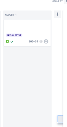

As you can see, the story in the Closed columns is marked as "Done".

Viktor Bjerre
December 7, 2018
I created a new project and it worked OOTB there.
The only difference I could see what that the last column was called "Done" instead of "Closed" which I had named my column.
I changed it to Done and started a new sprint and now it works.
Not sure if it was a bug in my last sprint or because of the column name.
Thanks for your replies.

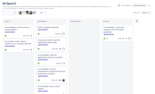

Is the "closed" status in the right-hand column of the scrum board?
Viktor Bjerre
December 3, 2018
Yes it is.
