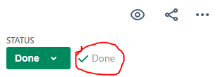

Found this issue with Jira.. In the new issue layout, The field Resolution is not displayed at all. (Not sure if this is a bug or its a feature that's WIP).
Once i set the resolution to Done in the old view, I see the new view updated with a Green Tick mark & Done Text next to Status.
