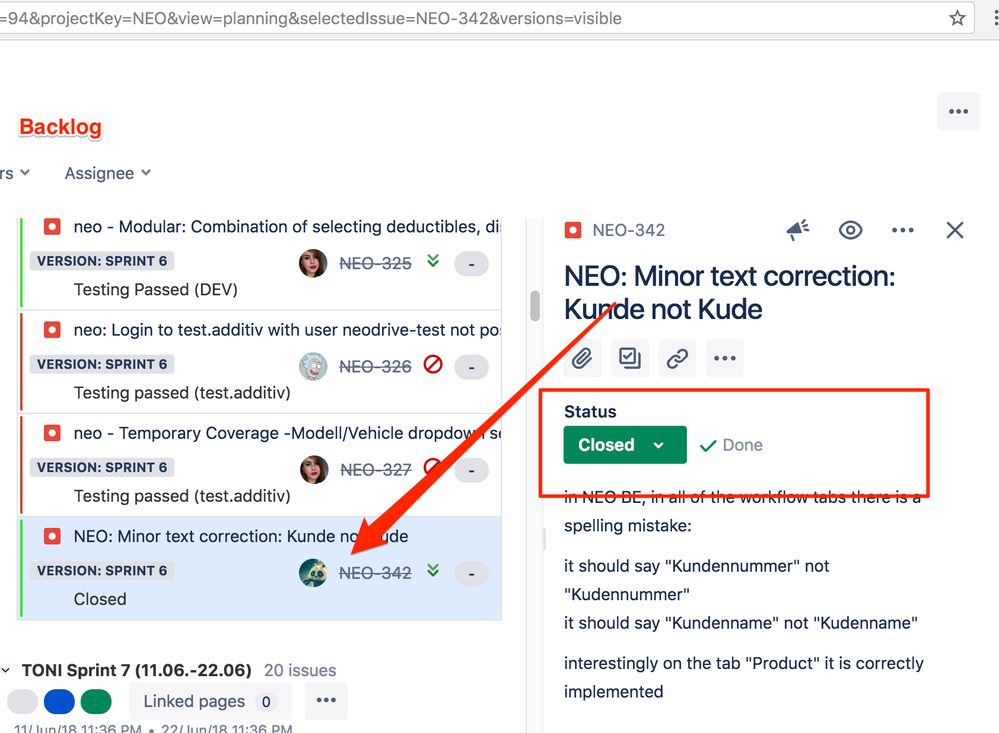

Hi guys, I m facing with one issue while configuring Scrum boards for three projects.
We are using new workflow for three different issue types and default jira workflow for other unassigned issue types. We created one shared Sprint ( sprint 1) for three projetcs. We are not using Resolved screen/Resolution.
The problem is that closed issues are displayed in backlog for active sprint.
- The status of the issues is closed.

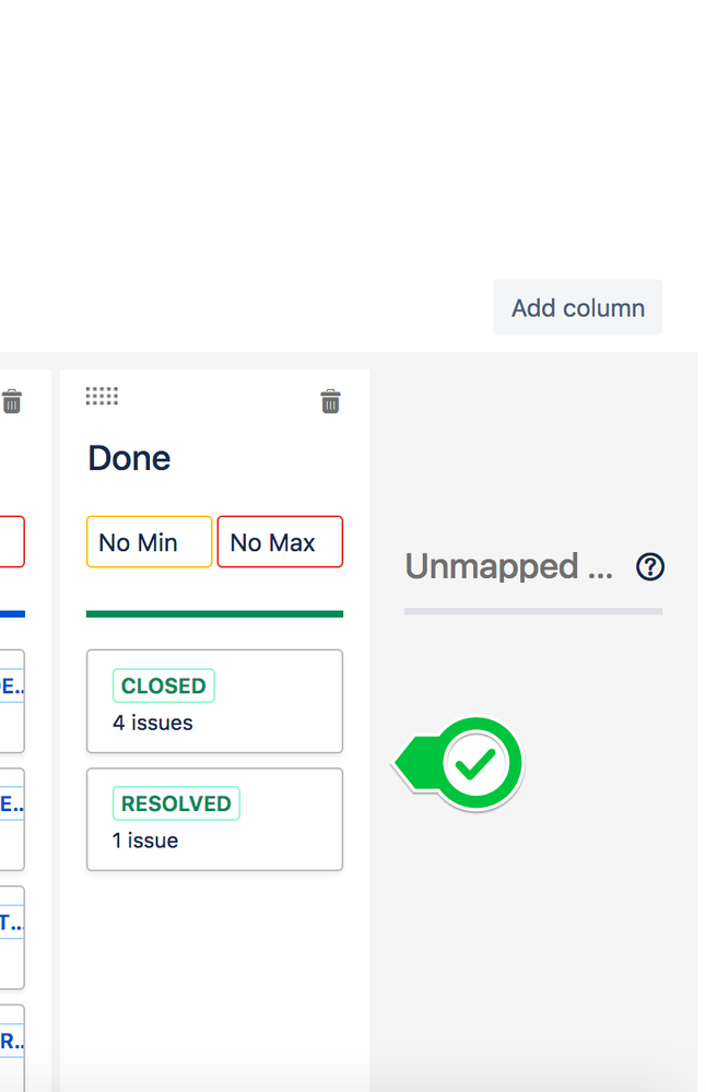

- "Closed" status is mapped to DONE/CLOSED column ...The last column on the right side (Columns board settings)
Is there any solution for fixing this problem and making closed issues not visible on backlog?

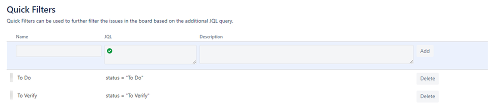

Alternatively, you can create a "Quick Filter" on your board and give it a JQL query that excludes the Closed status. Then you can just click the quick filter of/on while you view your sprint board.

Hi @jonny Adam, We want for closed issues  to show up on Active Sprints in the DONE column so we can be aware how many issues  have been resolved (closed) durint the sprint but I want them to not show up in Sprint list on  Backlog .. I tried with Quick filters, and that could be possible solution, but I read specification about JIRA  'JIRA Software does not display issues from the last column of the Scrum board configuration in the backlog section. If your closed issues are not mapped to the last column of the board, then they would be displayed in the backlog' and would like to figure out what is wrong on my backlog.

@Anida Softic, the only way to get rid of the Done from the Backlog is to create a quick filter. The good news is that even though the QFs apply to both boards (active sprint and backlog) they are set independently so switching back and forth doesn't leave them set/cleared.

@Anida Softic When an issue is closed or moved to done , It will show up in the sprint backlog and the issue number will have a strike on it and in your case you are asking what can be done so that you don't see the issues which are done in the active sprint backlog the best way is to use a filter TO DO, So that you can only see the issues which have to be worked

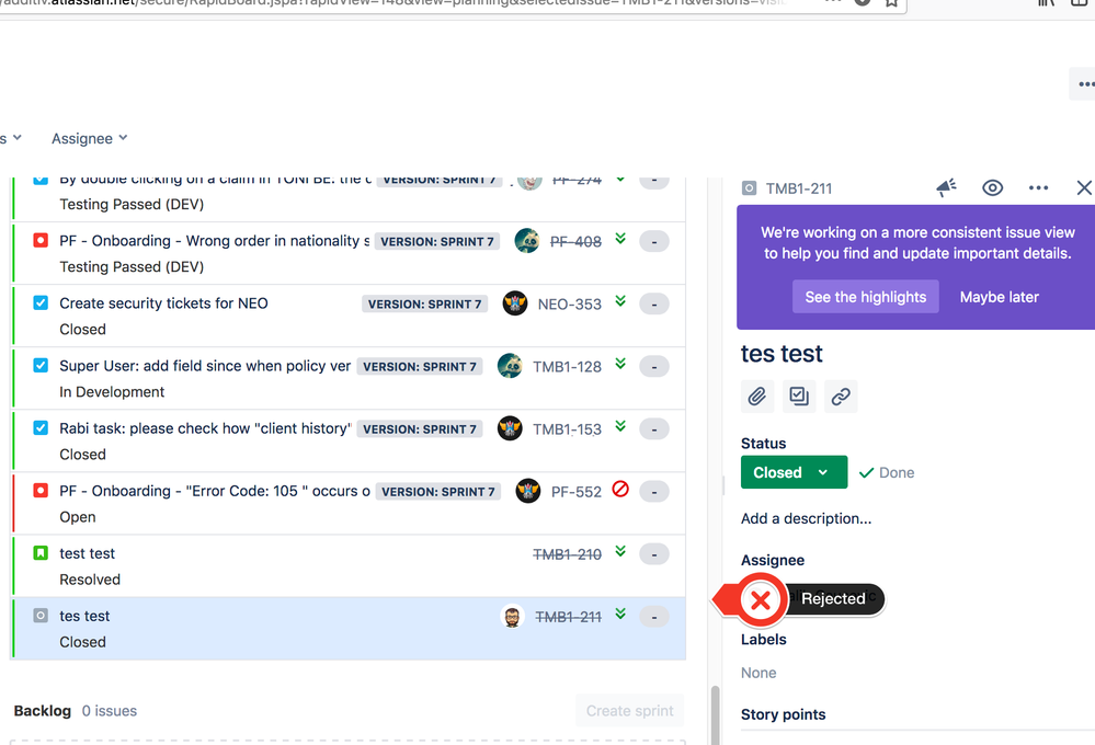

Anida Softic
June 27, 2018
@Moses ThomasI created new issue and set resolution to done, and Status to closed...But still able to see it on backlog...TONI_-_All_Sprint_7_-_Agile_Board_-_Additiv_JIRA.pngTONI_-_All_Sprint_7_-_Agile_Board_Columns.png

Anida Softic
June 27, 2018
Hi Jack,  thank you for you answer. I have one defect with Status=Closed and Resolution=Done ( Closed status is mapped to Done Column in the board settings) but still, it is showing up in my Scrum backlog!

Anida Softic
June 27, 2018
Hi Thomas, thank you for you answer. I have one defect with Status=Closed and Resolution=Done ( Closed status is mapped to Done Column in the board settings) but still, it is showing up in my Scrum backlog! Additiv_JIRA.png
