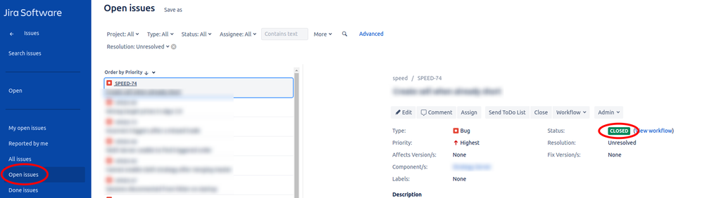

I am using Jira cloud.
I have opened my project page, and selected to view Open Issues.
As can be seen in the below screenshot, an issue which is marked Closed is showing up.
Why is this closed issue showing up?
How can I close the issue, thereby preventing it from showing up in the Open issues page?

Hello,
You need to set the Resolution field for the issues. Kindly read a similair question and the answers
https://community.atlassian.com/t5/Jira-questions/Done-issues-aren-t-shown-as-crossed-out/qaq-p/687203

How do I set a resolution?
I changed the status to Done, but can't set a resolution.

You need either
1. Set a screen with the resolution field for  the transition to the status Done. Then when you transition to the Done status you can choose resolution.
2. Add the Update Issue Field post function to the transition to the Done status and update there the resolution field to the required resolution.

For those completely lost when they find this ticket like myself. See here, and watch the video: https://confluence.atlassian.com/jirakb/jira-issues-need-a-resolution-826873869.html
You have to change the properties of the transitions. I know it says it above but I wanted to be more explicit and clear.
