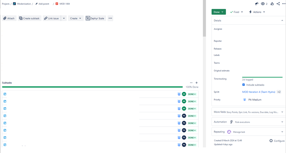

The history is as attached

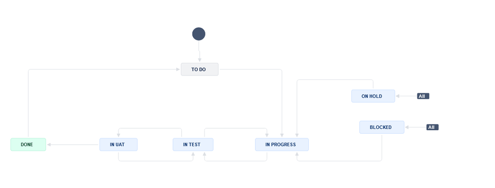

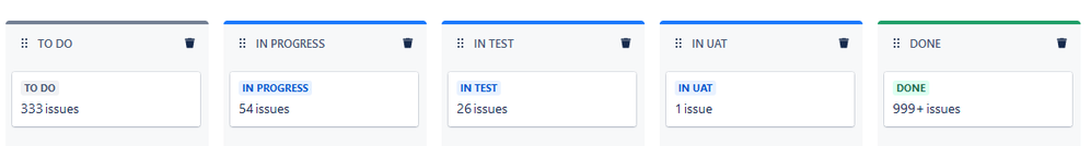

If the issue was indeed completed in the sprint, then it should never show up on the backlog such that it could show up in another sprint. Moreover, even if you manually changed it to add the active sprint, it should not show. The one possible exception would be if indeed, there has been some configuration change associated with statuses, and which status is considered complete. it would be good to see a screenshot of your board with the old issue shown in the sprint. It would also be good to see your workflow and the board column mapping.

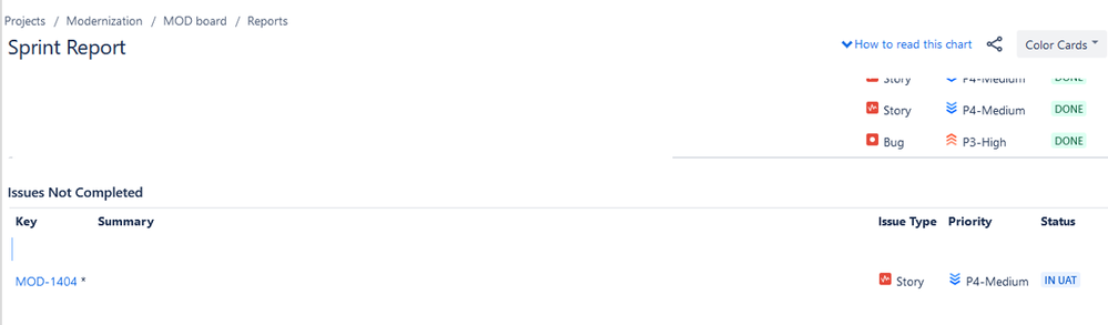

I have attached what I can but I noticed something on the Sprint Report, that particular issue that is shown to be Done on the status, it is showing as Issues Not Completed on the Sprint Report. Could that possibly be something that is contributing as the status is set to In UAT?Screenshot 2024-05-10 143444.pngScreenshot 2024-05-10 143201.pngScreenshot 2024-05-10 143035.pngScreenshot 2024-05-10 143000.png

@Drishti Maharaj , yes if it shows not completed is sprint and then added in new sprint it would show. If this is related to a single issue I would simply leave in the Done column when sprint is completed and be done with it.

Hi Jack, so it seems that it was completed though in a previous sprint. And when the new sprint added, it got added as well. Seems to be a few issues all completed in a previous sprint.
