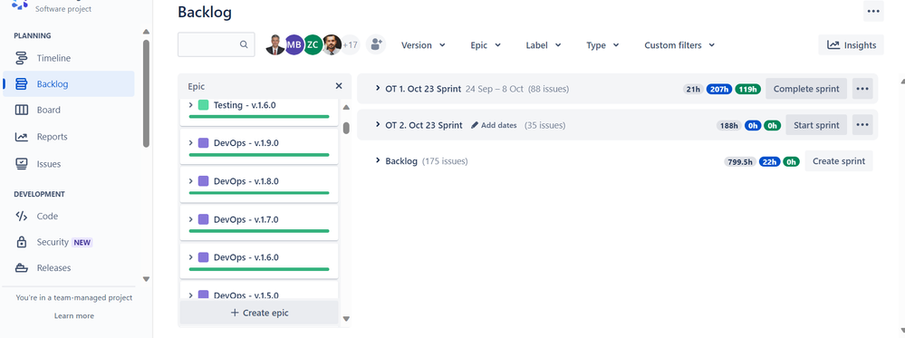

I just noticed it today. Not sure when it started but ALL closed Epics are now shown on the Epics Tab in the project backlog.
It wasn't like that in the past does anyone else have the same issue?

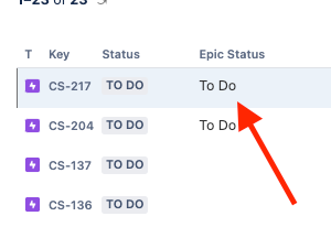

If they are in a Company Managed project, go to the Filters > View all issues screen and execute a search for the Epics. Set the output display for the search to List view and add the the column for Epic Status. What value do the Epics have for Epic Status?

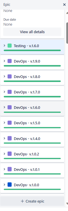

We are running a team-managed project. The epics are listed in the left of the screen as shown below:

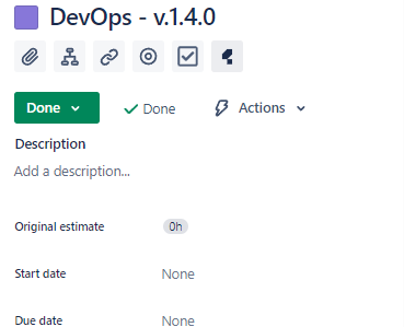

Yes, They are all complete.

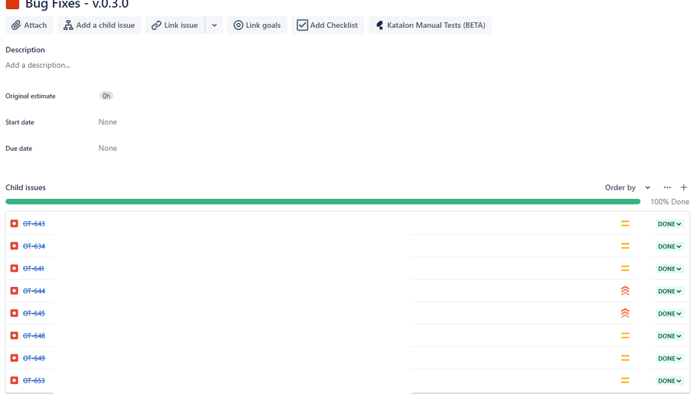

The Epic Below was completed on Feb 3rd, 2023.
It wasn't showing up until last week.

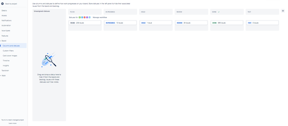

Can you show us the Columns And Statuses page from your board configuration?

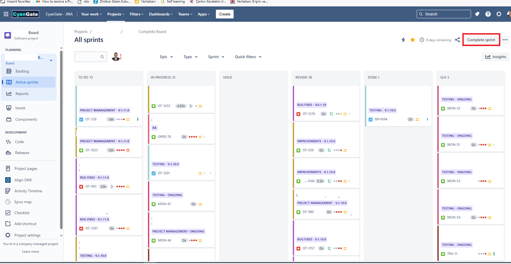

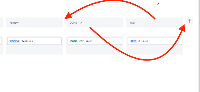

I think this all started when I closed a sprint from the complete board. The complete board is a board we use to manage all projects linked our main product. I had used the complete sprint function shown below. Maybe that's why all is getting mixed. If so, how can we undo it?
@Geylani Özçubukçu There are other status at the right most corner in your board after Done.
If you do this jira understands that the Done status is not the final status but the status which is at the end is the completed status.
This way your Done status actually is not a final status in jira and such tickets will be displayed in the board.
Please keep the completed status in the right most corner in the board.
I concur.
These columns need to swap positions in your Columns and Statuses configuration.
The Done column needs to be the one farthest to the right side.
Regardless of the status in the column, Jira will consider the issues in the column farthest to the right on the board to be "complete" in terms of which issues are "complete" in the sprints. Issues in all other columns will be considered "incomplete" and will display in the Backlog screen, including Epics in those statuses.

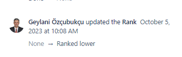

I did notice that somehow I did an action on all EPIC's.
I wonder if this caused it and how can I restore it?
