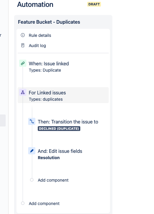

I've created an automation triggered when an issue is edited and used a branch for finding all other issues which are marked as 'Duplicates' however for some reason it does not work.
It did work when I tried the reverse direction.

Hadas
August 1, 2022

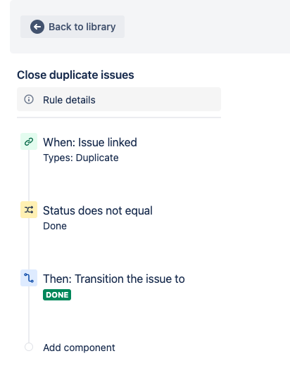

The rule you need can be found in the Automation Library. It is called Close Duplicate Issues.
Whether you select "duplicates" or select "is duplicated by" when you create the link, the issue in the linking that gets the "duplicates" setting is the one that gets closed.

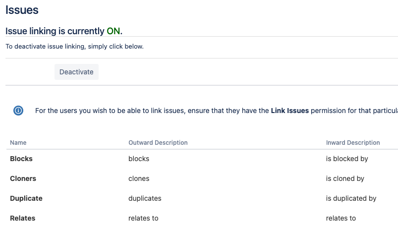

These are the link types I have.
With the rule I previously posted I tried two scenarios:
1. In issue A add a link to issue B and choose "duplicates" (A duplicates B). Issue A is the one that was transitioned to done.
2. In issue C add a link to issue D and choose "is duplicated by" (C is duplicated by D). Issue D is the one that is transitioned to done.
Experimenting with the rule by changing the link type used, what I find is that the issue that has the Outward Description part of the link is the one against which the Action gets applied.

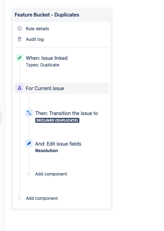

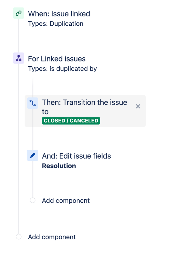

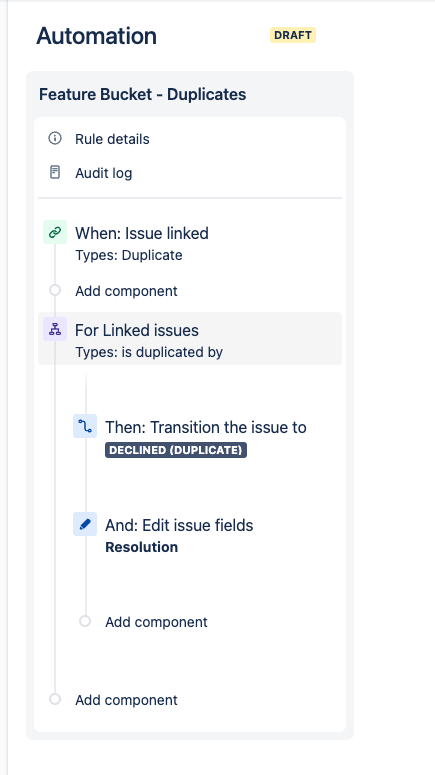

Screenshot 2023-03-10 at 09.01.00.pngScreenshot 2023-03-10 at 09.08.52.pngScreenshot 2023-03-10 at 09.08.45.png
