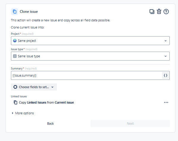

million dollar question... how do I select to copy the links from the current issue? I didn't see the option

Found the configuration option, however, it is still not working, and the message is very weird, since I am cloning into the same project and issue type...

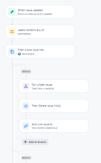

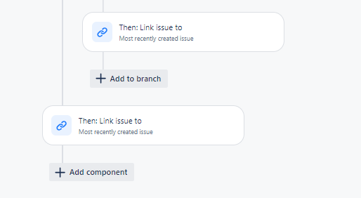

I ended changing the automation, and some Branches gave me the exact result I was looking for, though I have to do it in 100 issues chunks, it still works
An additional problem was related to some project configuration, apparently, even when I had linked issues, some "linked issues fields" were not present in the project, our internal support team managed to fix that
In case it could be helpful for someone else, I am including here the final version of the automation
