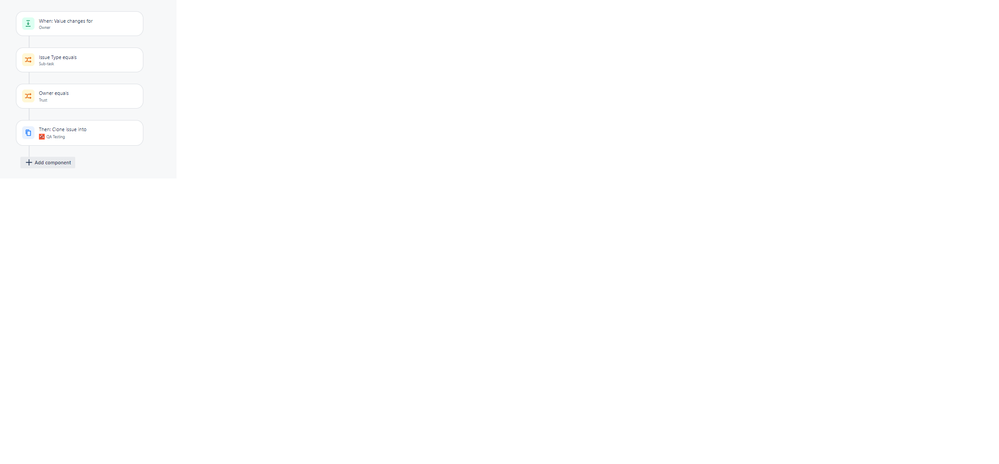

So I am trying to Clone the ticket to QA testing when the owner is Trust, please help me out.

In your rule you have a condition to confirm that the issue being processed is a sub-task.
A sub-task can exist only as the child of another issue.

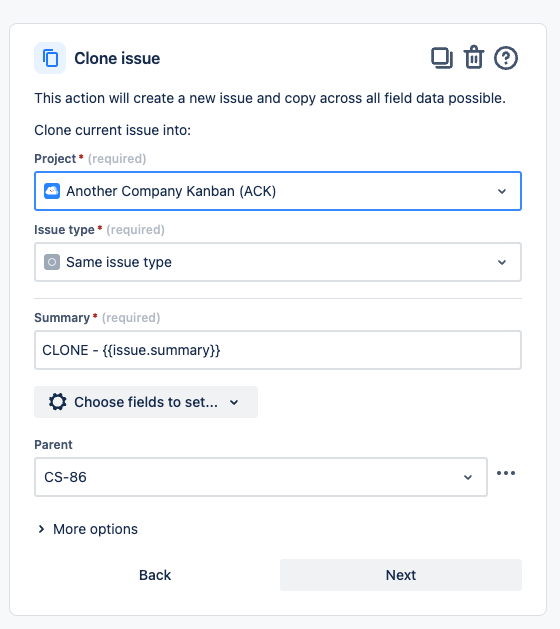

If you want to clone the sub-task to make a new sub-task under an issue in another project you will need to specify the issue in the other project that will be the parent of the new sub-task. Notice in this example I am setting the Parent field to the issue key for that issue.

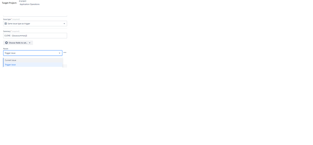

And when I click on Parent I only see these 2 options. @Trudy P Claspill Untitled.png

When you create a sub-task it must have a parent issue.
When you clone a sub-task it must have a parent issue.
A sub-task's parent issue must exist in the same project as the sub-task itself.
So, if you want to clone a sub-task to make a new sub-task in a different project then you have to specify another non-sub-task issue in the target project as the parent for the newly created sub-task.
Besides selecting from the list of options for setting the Parent field you can also type in a value in the Parent field, like I showed in my example.

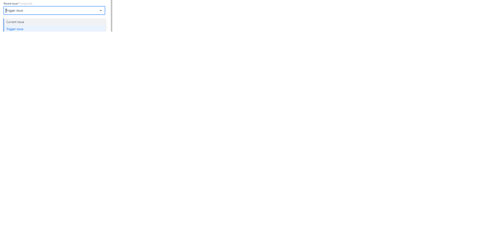

I am not able to change the target project and on the parent field I have only Current issue and trigger issue optionUntitled.png

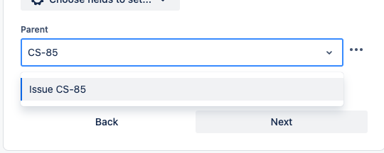

You need to directly type into the field the Issue Key for the issue that will be the parent of the new sub-task.
