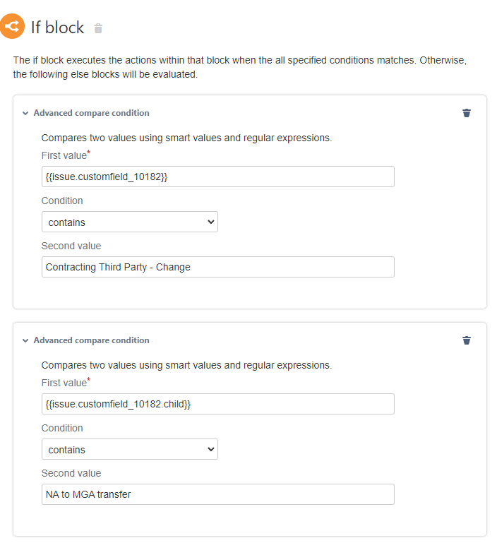

I am checking if the cloned ticked for a 2 level cascade field called category/sub-category contains the following values: Contracting Third Party - Change / NA to MGA transfer
If the new cloned sub-task ticket contains those values then update/edit field values:

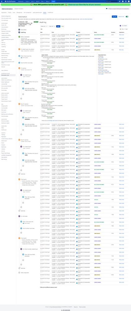

Mary Mark
October 24, 2023
Hi @Bill Sheboy

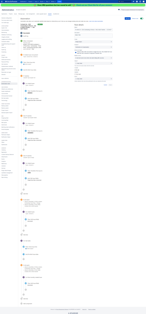

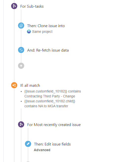

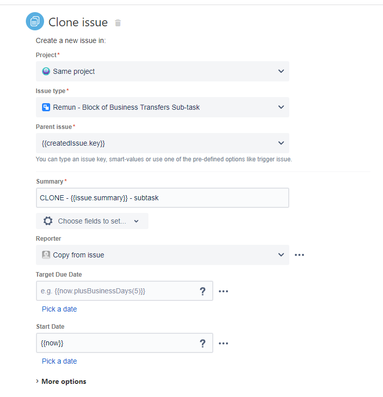

Here is the complete image of the automation rule
The issue in question is this section: For Sub-tasks
Here are the detail actions
Logs attached.
The tickets / issues created.

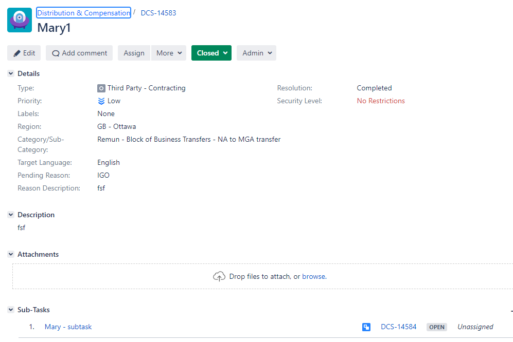

This is the original parent ticket. Issue 14583 created.

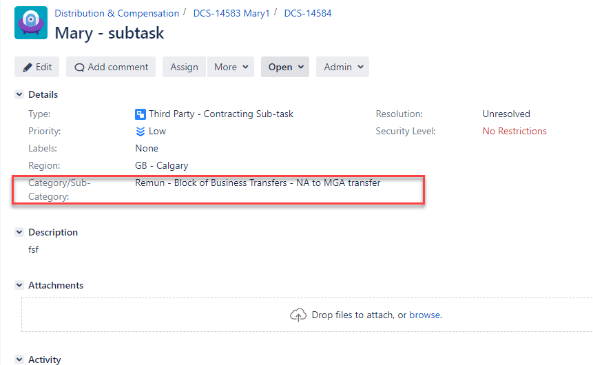

Original subtask: DCS-14584
Subtask ticket: 14584

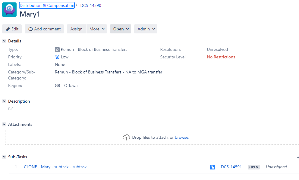

The category / sub-category values should remain as: Third Party - Contracting / NA to MGA Transfer but after cloning the sub-task to the new parent subtask ticket, the 1st level category of the original sub-task ticket got changed from Third Party - Contracting TO: Remun - Block of Business Transfers

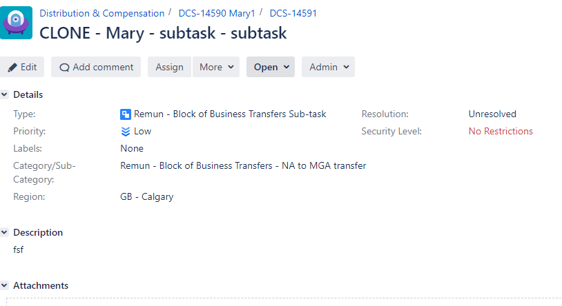

This is the clone ticket of the parent: DCS-14590
The clone subtask ticket is: DCS-14591
The values for Category/Sub-Category is correct.
I am not sure in the rule if I am using the right branch. I am thinking whether the automation is confused with the updating the field values for the sub-task from the parent ticket with the sub-task from the new cloned ticket.
The category/sub-category values of the sub-task ticket on the original parent ticket should not change/get updated.
Thank you!
Mary
Bill Sheboy
October 24, 2023
Thank you for all of those details, Mary!  That is a complex rule, that I suspect is not working as you intended...due to a couple of things.
First, rule branches which could be on more than one thing (e.g., on linked issues, on subtasks, etc.) are processed in parallel and asynchronously, relative to the rest of the rule.  This means that the branch will not complete before the next rule step.  Indeed, the branch may not finish up until the last step of the rule.
Your rule contains several such branches, and so that will certainly lead to unpredictable behavior.
Next, when an issue is created inside of an if/else or branch structure, the smart values for the most recently created issues are not reliable, because they happened at another scope.  There is a work-around for that for Jira Cloud, but not for Jira Server automation.
My recommendation is to pause and map out what you want this rule to accomplish.  That may then require creating multiple rules rather than one large one.  Thus one rule may perform an action which leads to the triggering of another rule.
As a start, I recommend splitting your rule by Transfer Type, adding that condition to the JQL, and so you would have multiple, smaller scheduled trigger rules.

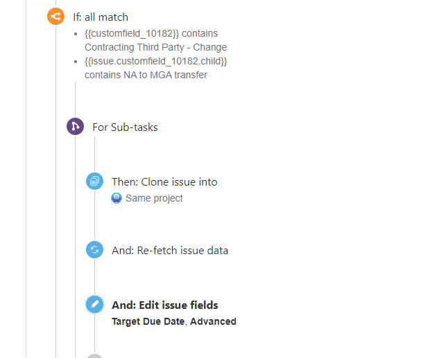

Thank you so much for reviewing. I did break this up. Instead I focused on the subtask piece in a separate automation rule. However, cloning the subtasks works. It’s when you come to update the values that it’s not correct.

Bill Sheboy
October 25, 2023
For Jira Cloud there is an action for Create Variable, that allows saving the key for the newly created issue for later use.  That can work-around the scoping issue for if/else structures.
Back to your rule: when you not the value update is not working, what is happening?  Would you please post an image of your new, smaller rule and its audit log showing execution details?
Mary Mark
October 25, 2023
Hi @Bill Sheboy

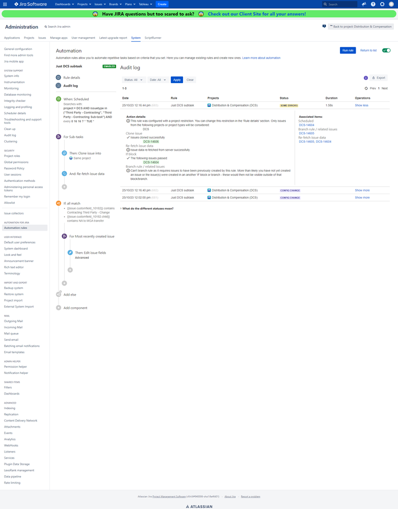

Please see screenshot attached.
The ticket was successfully cloned but the updates to the customfield values is not working and do not get updated.

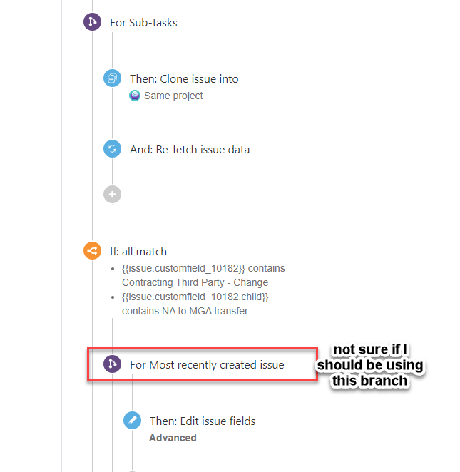

Bill Sheboy
October 25, 2023
Recalling that thing I mentioned about branches, scope, and "most recently created"...your second branch likely cannot work because the rule cannot "see" there was an issue created.
What is happening in that last Edit Issue action?
Could the changes be done at the same time as the cloning, which would eliminate the problem?

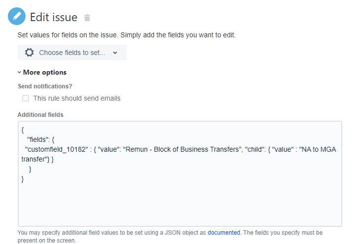

I believe you can do that at the same time as the clone action, using an advanced edit with JSON.  Have you tried that?
Mary Mark
October 25, 2023
I’m not familiar with that do you have an example? How would I reference the new subtask to update values in the json?
Bill Sheboy
October 25, 2023
You appear to already be doing that in your Edit Issue action.  That JSON could be copied and used in the Clone Issue action instead.  When cloning, any field values can be replaced (rather than copied) if provided in the action.
Here is the advanced edit with JSON reference, just in case you want to check your expression: https://support.atlassian.com/cloud-automation/docs/advanced-field-editing-using-json/#Cascading-select-custom-field

October 23, 2023
I also tried this and the new cloned ticket reflects the updated values however the original sub-task values also got updated too.
