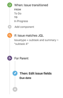

After trying some options using Automation for JIRA, I was able to achieve the functionality you were looking for by performing the following steps/requirements:
- Create a date custom field and add it to your project screens
- When starting the progress on The sub-task 4, you must require the user that did it to fill the created field 30 days ahead of the current date
- Configure the automation rules like the below:
P.S: I used the Due Date field to trigger the last automation rule.

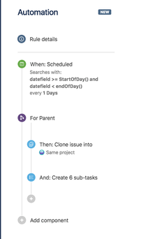

- Create a rule that will check once in a day if the date field was reached (With the query below) and Clone the parent issue of the sub-task which breached the date.
datefield >= StartOfDay() and datefield < endOfDay()
Please, let me know if this makes sense to you.

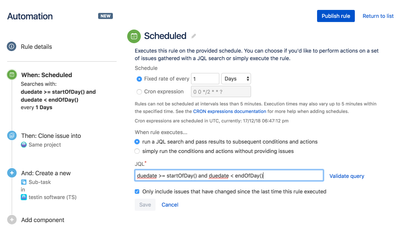

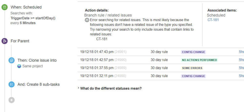

I had to tweak it slightly as using <end of day wasn't bringing back any results and I changed the schedule to 5 minutes to test. However I get the following error.Automation Error.PNG

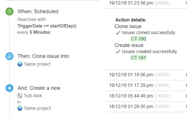

Using the below automation works however the sub task doesn't get created!  Any thoughts in why this would be?
