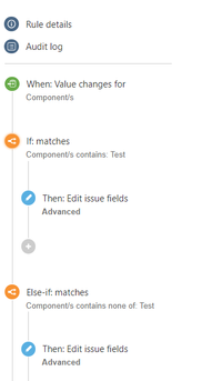

Would you please post images of your complete rule, the actions with the edits, and of the audit log details.  Those may provide context to help explain what you are observing.  Thanks!
Harsh
November 15, 2023
Hi @Bill Sheboy
I can share the audit log for sure.
The first one shows success when I use the JSON in EDIT Action as below. It says success but user is not added nor removed(else if condition)

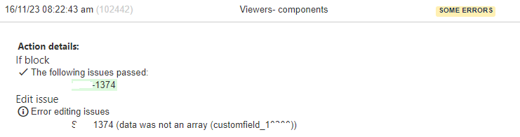

Harsh
November 17, 2023
Hi @Marc -Devoteam-
Update, unfortunately it did work.
It throws an error - 'data was not an array'
customfied_14296 is User Picker (multiple users) type, does this mean it is not considering the field at all?
Thanks!
