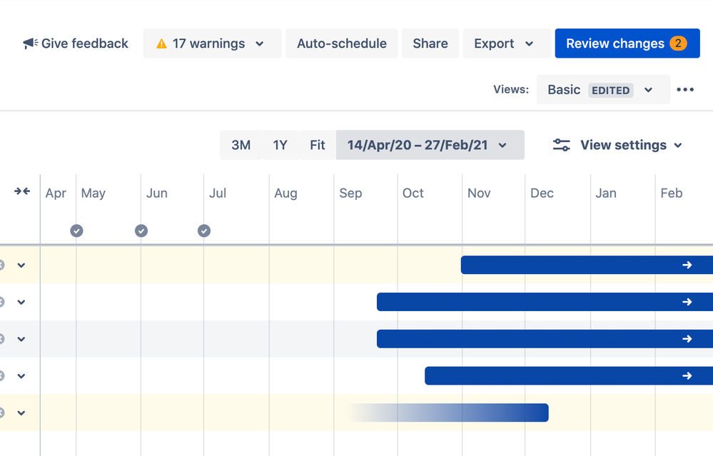

Issues created in the roadmap view are not saved instantly in Jira. As soon as you add / update any data in your roadmap, you should see a big blue button light up in the top right corner: Review Changes:
When you click that button, you will see an overview of all the changes you made in your plan. When you click Save selected changes to Jira there, your issues will be saved to Jira and appear on your board.

We are on the cloud based version/Next Gen and nothing similar to what you describe appears in the Roadmap.

Hi @Ilan Brender,
Oh, my apologies and thanks for clarifying ! I was assuming you were on the premium plan and using advanced roadmaps. I was referring to that functionality in my answer.

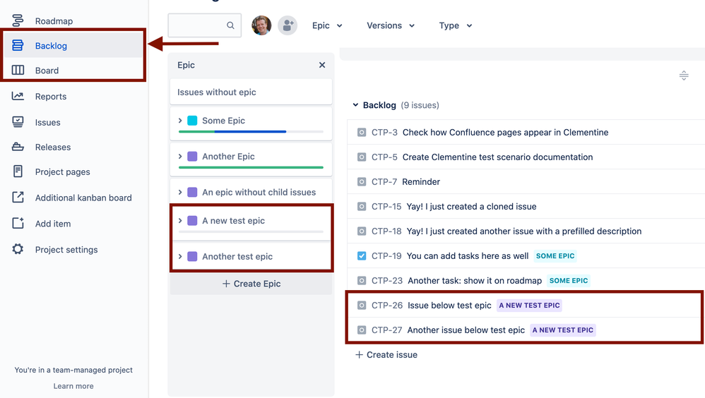

Could you check if you have enabled the backlog of your board? Because if you do, your issues will appear in the backlog view, not on the actual board:
I created 2 epics and 2 issues on the roadmap of my test project and the above screenshot demonstrates where they (should) pop up.

Ilan Brender
April 13, 2021
That's it! I did not catch that connection. So absolutely a feature.
