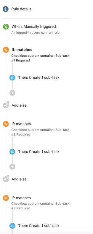

It's possible to achieve this functionality by using 3 seperate if/else blocks which each check if your checkbox contains one of the checked fields. We have a new issue condition field which makes this easier with select fields/checkboxes, which you can see in my screenshots below. Your rule would be something like this:
  • Trigger: Issue transitioned

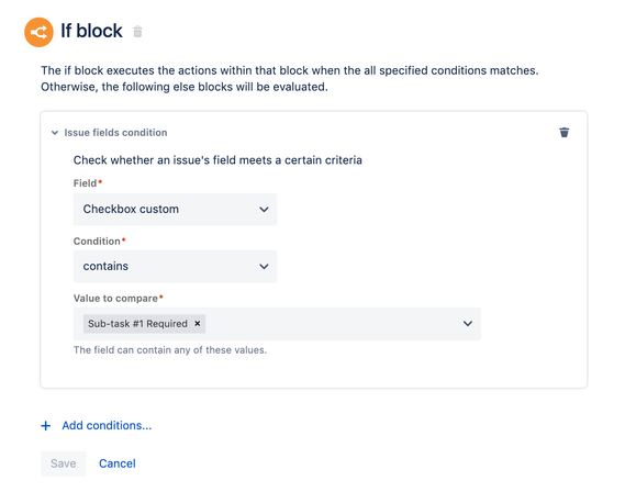

  • If/else block
    • Issue condition: (You could alternatively use our JQL condition that looks for the selected checkbox field)
      • Field: Your condition field
      • Condition: Contains
      • Value to compare: First field selection

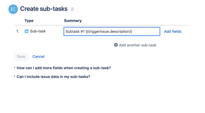

    • Create sub-task
      • Add your sub-task and you can access fields from the issue using one of our smart values e.g. {{triggerIssue.description}}
      • Clicking on add fields will let you set multiple issue condition fields
  • if/else block
    • Same as the above with Second field selection value
  • if/else block
    • Same as the above with Third field selection value
If you would like more help on getting this use-case working, you can contact our support here: https://codebarrel.atlassian.net/servicedesk/customer/portal/1. Or find more information in our docs here: https://docs.automationforjira.com.

Condition:
Create sub-task:

This is great. Thanks, Much easier than I thought it would be. It was same as above but with creating a new issue in a separate project. I ended up doing it from a workflow global transition so that the transition screen would show. I coudn't get a transition screen to appear from a manual trigger.
Automation for Jira is amazing, coming from using ScriptRunner for everything before (at a different company) I'm finding Automation is just as powerful in most cases without all the groovy... Also the audit log and alerts for logging too are just awesome. You guys have the best support. Just so impressed. Thanks again.
