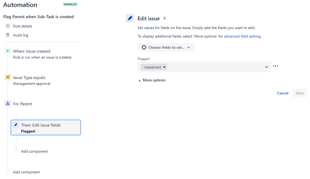

Rule #1: Flag Parent when Sub-Task is created
We want the flag to be set as soon as a sub-task exists:
  • TRIGGER: Issue Created
  • BRANCH (Parent)
    • ACTION: Edit Issue (Select the Flagged field)
      • Select "Impediment"

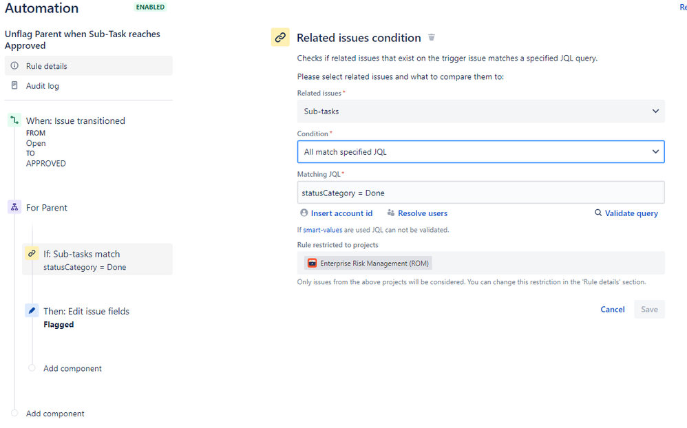

Rule #2: Unflag Parent when Sub-Task reaches Approved
This will only unflag the parent when the last sub-task has transitioned to APPROVED status
  • TRIGGER: Issue Transitioned
    • To: APPROVED
  • BRANCH (Parent)
    • CONDITION: Related Issues condition
      This condition will make sure that there aren't any other sub-tasks in some type of To Do/In Progress state
      • Sub-Tasks
      • All Match specified JQL
      • statusCategory = Done
      • Leave blank to clear it

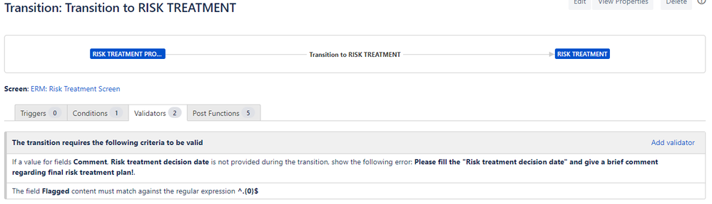

@Mark Segallsomehow that didn't worked. Should I add the field "flagged" to the Risk Screen? Here are the screenshots from them, what I've been set so far:

  1. Since the sub-task is created by way of automation, you'll need to check the box under Rule Details
    1. Check to allow other rule actions to trigger this rule. Only enable this if you need this rule to execute in response to another rule.
  2. You should not need to add flagged to the screen, but it should be available in the field configuration scheme
Like • Lukas likes this

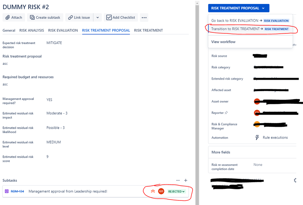

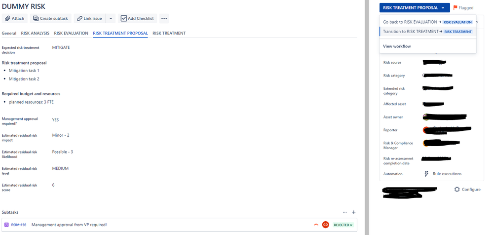

Lukas
October 7, 2022
@Mark SegallNow I'm one step ahed, so parent issue get flagged now. But I'm still able to transit the issue, even approval subtask is rejected as you can see at the screenshot below. What could be the reason?

Mark Segall
October 7, 2022
You know what...  I had to use a validator in my past and your use case would need a condition.  With a validator, the option is still there, but it will error on you if you try to select it. Whereas a condition will hide the status altogether.
So, let's do this:
  1. Remove the validator
  2. Add a condition
    1. Value Field
      1. Flagged != Impediment
Sorry about that.

Lukas
October 7, 2022
@Mark SegallNow that thing works, how it should be :) Thank you man! I appreciate that a lot!
