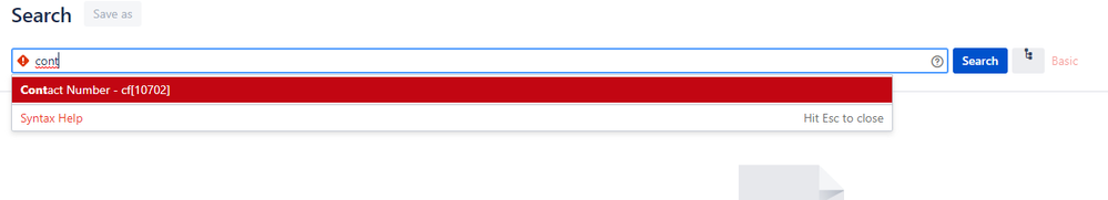

On this topic, how do you go about finding out what the custom field ID is?  I have a custom field called "Environment" which is a list of six, single-select, drop down choices, but I'm not sure how to find out what Jira thinks the ID's of each of those choices are.
Thanks,
Jeff
Paul Mata
August 18, 2021
@Jeff Hayes one way is to do a search for issues (Advanced mode) and as you type the field name into the query, it will show you the custom field id. The ID is for the field, not the responses. The responses are what you would check for in that if statement at the end of the script.
