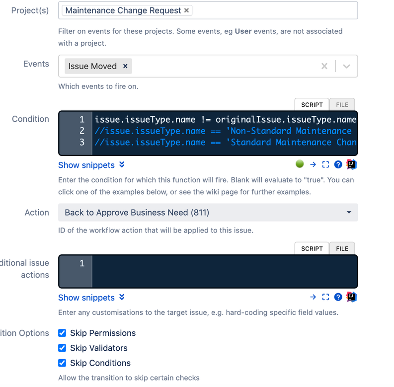

Now I tried as you described above just create 2 listeners: as in the screenshots and not addining anything to the postfunctions. still doesn't work for me.

  1. Can you confirm if you have "Issue Moved" event triggered properly when the issue-type change happened ?
  2. You don't need to check if the current and previous issues types are different . It will be different - that's what the first listener does. You can leave the condition blank and see if the second listener gets triggered .
  3. You can use below condition instead :
def types = ['issuetype1','issuetype2']
issue.issueType.name in types

Ah it helped, thanks a lot.
