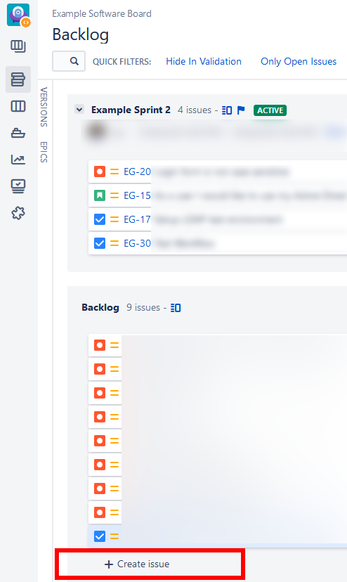

The issue occurs when being in the "Agile Board" backlog where there is also a shortcut on the bottom of the screen for creating issues as shown on the picture below:
  • Is it possible to also target the behavior of this "Create Issue" shortcut via a Groovy script ? The link provided above does not impact this element.

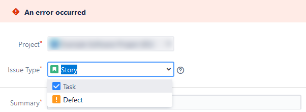

Therefore, Developers (they can't create a bug) will still be able to select the "Bug" issue type as shown below.
Then the validator will run and open the "Create Issue" window while generating an Exception and only then the behaviors will restrict the the types, in the UI, to only three (Story, Task, Defect).
  • Is there a way to modify the UI of the issue creation in the backlog to hide the issue types a user doesn't have the rights to create ?
