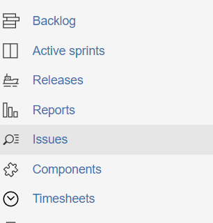

If I change schemes and workflow the project itself become what I want it to be. But there is project menu on the left side which is not changing. If I want to change Basic SW project to Scrum project I would have all schemes from Scrum but no Sprint menu on the left still. Like this:

After the board creation the left side have got refreshed and has all menu lines as I wish!

This has changed slightly since then - this question is three years old!  Project Type now has an effect - business, service desk or software affects what you can configure for it.
To make sprint appear for a Software project, create a Scrum board for it.
