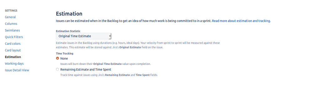

Hi @Pam Graunke
you can change what you see on the card in the board setting.
When time tracking is set to none, you will see Original Time Estimate. When you change that setting, you will see the Remaining Estimate.

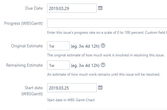

Vilmos Koschek
March 25, 2019
Hi Pam!
Did you set every field?  If you change Original Estimate you have to set Remaining Estimate again. It works for me well.
br.
Vilmos
