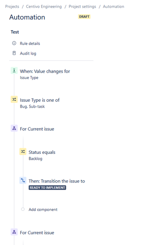

I've been trying to create an automation that triggers whenever the issue type from a parent issue is updated to a sub-level issue (see the screenshot below).
Problem: Jira doesn't trigger when I update the issue type from a Parent-issue to a Sub-issue. It only catches updates from issues of the same level, e.g (from User Story to Defect; or Sub-task to Bug; but never from Defect to Bug).
Does anyone know why this is happening and how I could solve this issue?

Hello @Wesley Maffazzolli
How exactly are you changing the issue type from Parent-issue to Sub-task? Are you using the Convert To Subtask option for the parent issue?
If so, so far I have not been able to get a working solution either.

There was this suggestion closed as Won't do - AUT-463 - Trigger and action for converting issue to sub-task and vice versa in an automation rule then this as well - AUT-1960
unfortunate.

"How exactly are you changing the issue type from Parent-issue to Sub-task? Are you using the Convert To Subtask option for the parent issue?"
Answer: I've directly clicked on the issue type icon I want to change (see the screenshot below - in that example I'm trying to capture the event of a Defect becoming a Bug).

Okay, the method you indicated does invoke the Convert to Sub-task process when you select Sub-task. That is the process that there doesn't seem to be any automation options available to catch.
