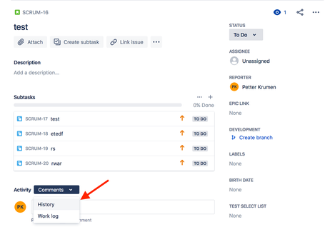

By default, all the update activities performed on JIRA issues are registered under the history tab, at the bottom of the issue:
If the date of the latest activities under the history tab is not the same as the field, can you please provide us a screenshot with the latest activities you have under the history tab? P.S: Make sure to hide any sensitive information on the screenshot.

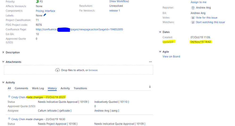

I knew about the History tab you are talking about, I rechecked there for several times and even tried some scripts to get the activity list of the issue, thinking some logs might deleted or hidden. But no use of anything.
Here I attach the screen shot of the issue for what I'm breaking my head. Please find the screenshot and help me out of this.
