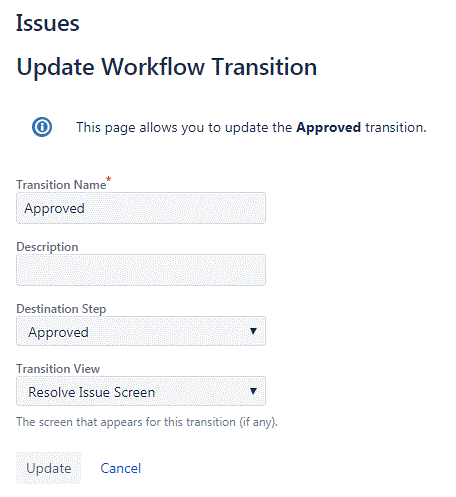

Amy Lee
March 15, 2019
Hi:
I had a similar problem and realized that I wasn't using the correct transition screen when moving issues to "Done." There is a default "Resolution" or "Resolve Issue Screen" screen, I believe, that you can use as the Transition View and which will update the Resolution. To do this, you would go to the workflow, click on the transition that moves the issue to "Done" or "Commissioned" and then edit the transition to use the correct screen (see below).
I hope this helps!
