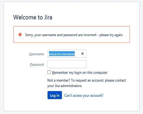

I have installed a new UAT JIRA based on a restored database from Production.
Although I changed the dbconfig.xml with the correct schema, I am still not being able to login into the schema I need.
Every time I log, I get to the empty JIRA schema.
Can you help me?

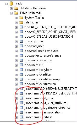

Eduardo Menezes
June 24, 2019
Hi Nic
Imagine the following.
In this restored database I have two schemas and I have users on the following tables
  • dbo.cwd_user
  • jiraschema.cwd_user
When I log with the user on the dbo schema it works.
But when I log with user on the jiraschema schema it does not work.
Let me know if it was clear my issue?

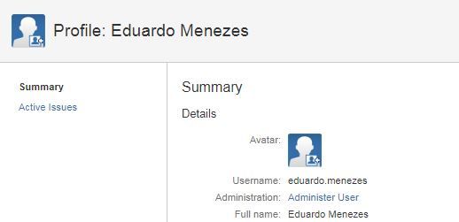

Eduardo Menezes
June 25, 2019
Would this help?
This is one from Production
Nic Brough -Adaptavist-
June 25, 2019
If you have the credentials from the source system, you should be able to log into it.

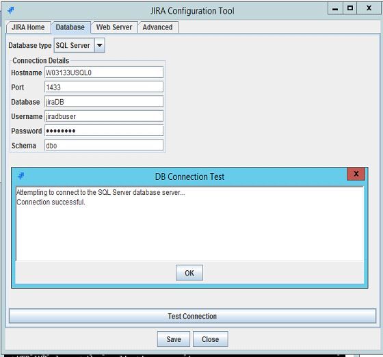

June 22, 2019
All we can tell you here is that your dbconfig.xml is wrong, or the database that you have restored is not right.  Could you tell us, in more detail, what you have done and what the errors/messages are as Jira starts up?
Eduardo Menezes
June 23, 2019
Hi Nic, thanks for your reply
The dbconfig.xml looks correct once confirmed with images

the database has the schema that I want but it looks like I am missing someting to start the application under this new schema
because when I try to login with the user that is on this schema, it's not recognized
but if I log with the user that is on dbo. it works.
