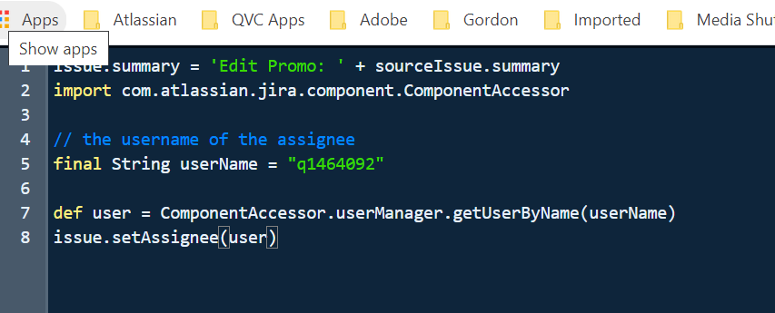

Gordon Rutherford
March 5, 2021
Thank you Fabio that is working perfectly for me and I really appreciate your time on this.
Could I just ask if I wanted to combine your code with my code below which is to create a sub task and amend the name and assign it to a user, what would that look like?
Thanks again
Gordon

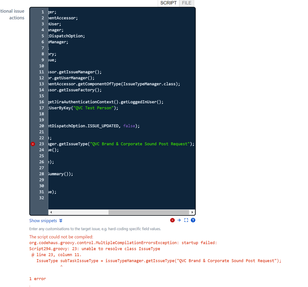

Fabio Racobaldo _Catworkx_
March 10, 2021
Hi @Gordon Rutherford ,
try this code, I missed import of IssueType class :

Gordon Rutherford
March 10, 2021
Hi Fabio
Only just came back to try this now so apologies for the delay - I get the error below on the line where I have entered the name of the sub task
Regards
Gordon

I realise I should have brought more detail - there are two use cases for this script - one when an issue is created (not updated) and perhaps that is causing this error shown in snip image shown below when I inserted it in that post function?
The other is changing a subtask reporter when the sub task is created by scriptrunner with this additional issue action which I want to add to with also the 'change of reporter'
issue.summary = 'Add Chan PD Image Request: ' + sourceIssue.summary
import com.atlassian.jira.component.ComponentAccessor
// the username of the assignee
final String userName = "q1424781"
def user = ComponentAccessor.userManager.getUserByName(userName)
issue.setAssignee(user)
Thanks for your help with this!
Best regards
Gordon

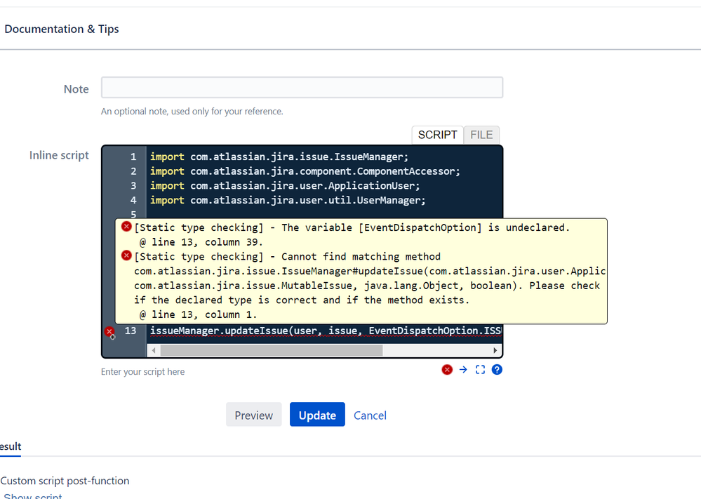

March 4, 2021
HI @Gordon Rutherford ,
here the code updated (the problem was that EventDispatchOption was not imported).
Please move this post function after issue creation.

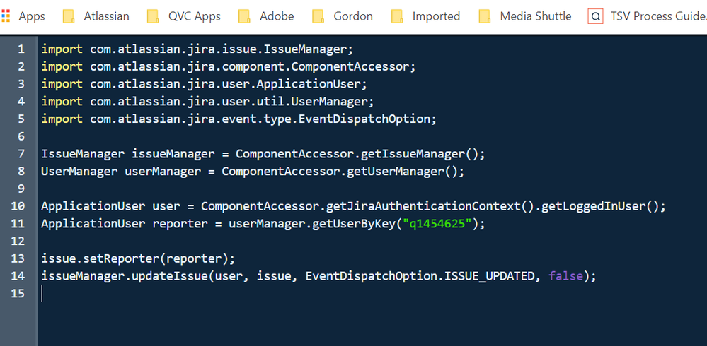

Thanks for your response! So I have inserted the new code after 'Create' in the post function order as shown below where 'q1454625' is the 'new' reporter I want for the issue. This however does not update in the created issue - Reporter shows as 'anonymous'.
Sorry if I am missing something as I also didn't understand you last comment:
'Moreover, in order to set the reporter use the method issue.setReporter(user) as per Assignee.' Does that mean I need to add some extra code to the script shown below to make it work and update the Reporter?
Thanks again for your help

import com.atlassian.jira.user.util.UserManager;
import com.atlassian.jira.event.type.EventDispatchOption;
IssueManager issueManager = ComponentAccessor.getIssueManager();
UserManager userManager = ComponentAccessor.getUserManager();
ApplicationUser user = ComponentAccessor.getJiraAuthenticationContext().getLoggedInUser();
ApplicationUser reporter = userManager.getUserByName("YOUR_REPORTER_KEY_HERE");
issue.setReporter(reporter);
issueManager.updateIssue(user, issue, EventDispatchOption.ISSUE_UPDATED, false);
