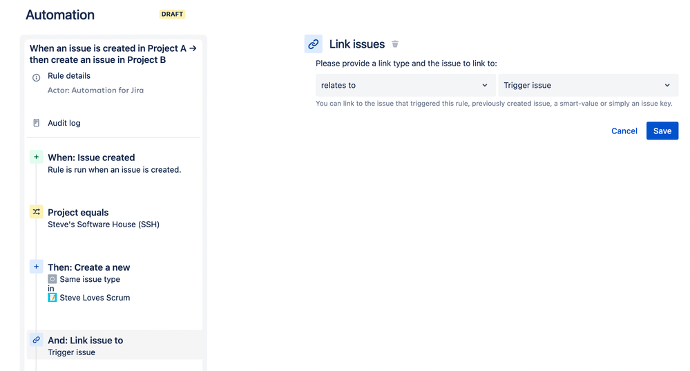

By modifying the automation rule that creates your issue originally, you can add the currently missing link. As in the example below, add a link between the newly created issue:
note that this will enable you to use this issue link in the future, but it won't fix the missing link for issues you created previously. You may want to try and fix the missing link for any still open issues you have around manually.

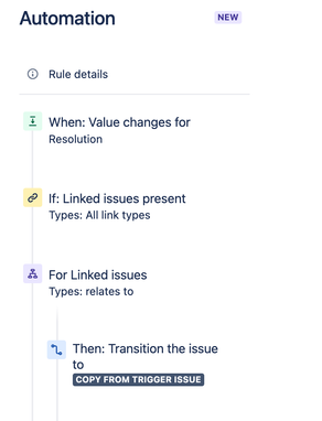

Once you have this in place, you can quite easily trigger status update between linked issues in the future. Using an automation like this one:
Since your question suggests your issues are stored in different projects, you would have to use a global automation rule indeed to make this work. As a recommendation, you may want to either restrict the scope of your automation rule to just your project A and B to avoid it kicks in each time the resolution is set to an issue all over your Jira instance. That is something you can specify in rule details > scope.
