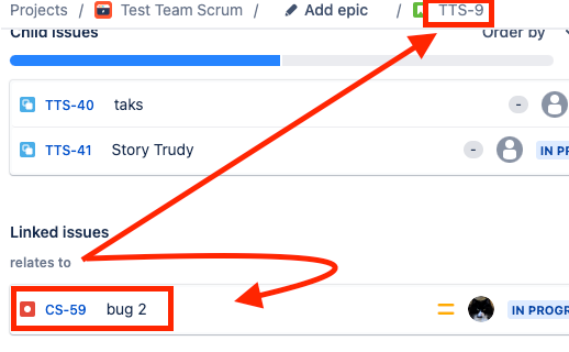

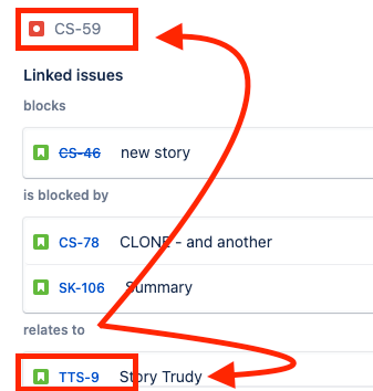

When two issues are linked with the "Related to" link type and you view each issue and look at the Linked Issues section, what does it say in each issue for the link relationship to the other issue? Does it say the same thing in both issues?
If they say the same thing, that makes this much more difficult.
Automation for Jira has a trigger to detect that an issue has been linked, however it is triggered by the link addition to the "source" issue. For instance in the blocks/is-blocked-by link relationship, the issue that is causes the blockage is considered the "source" issue. If the link type you are using shows the same link text in both issues, as I showed in the images above, then you don't know which issue is the one that the rule would consider the trigger, or source, issue. That makes it harder to figure out which one needs to be changed.
Based on experimentation in my system with the Relates To link, it appears that the issue from which I created the Relates To link is always considered the trigger/source issue in this case. So, if you created the link from the Project B issue to the Project A issue, then the project B issue would be considered the trigger/source issue, and you could create the automation rule in project B to transition the Project B issue when the link was created.
If you always or sometimes create the link from the Project A issue, though, you would have to use branching to get to the issue in project B to transition it. That would make the rule a multi-project rule, and only a Jira Administrator can construct a multi-project rule.
