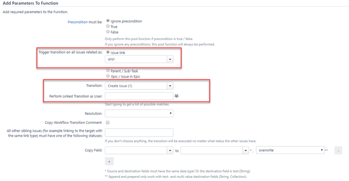

This is easy to accomplish using the Jira Suite Utilities plugin and you can avoid any scripting.
If you have the JSU plugin, then at the Post-function of your transition choose the option of Linked Transition (JSU)
In the next screen, specify the parameters and rules of the transition as required.
