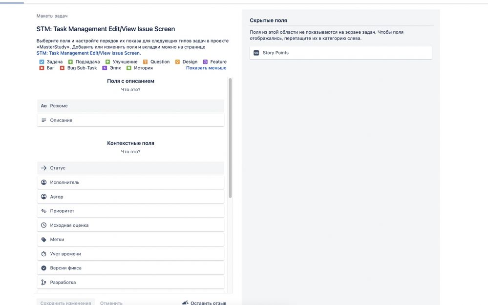

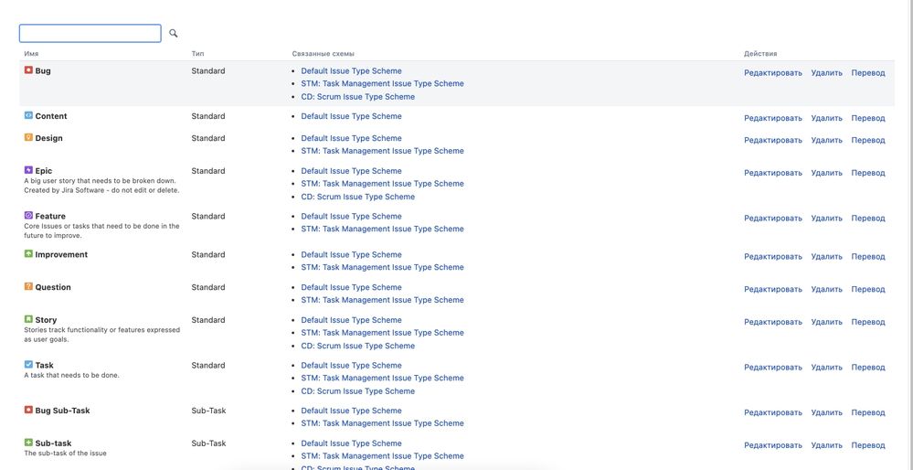

@Nic Brough -Adaptavist- looks like you didn't even try to test the problem.
I have the same problem as described by the guys above.
I can easily change the task type from "Bug" to "Task", but vice versa "Task" to "Bug" it redirects me to this "Move" screen
Below is a screenshot with the fact that I have the same fields for both issue types and issue types are configured in the same way
So please NOW explain to us what is the problem and how can we solve this?
Please do not pretend that there is no problem when several people signal to you that there is one.
