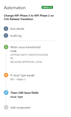

Mike McNamara
October 6, 2021
I can do this successfully using Automation. For us, there is no concern regarding how the change may impact fields, workflow, etc. as this workflow is for a business process and the issue type helps define different types of the same activity.
Nic Brough -Adaptavist-
October 6, 2021
Yep, it'll work when the two issue types are configured the same way.
