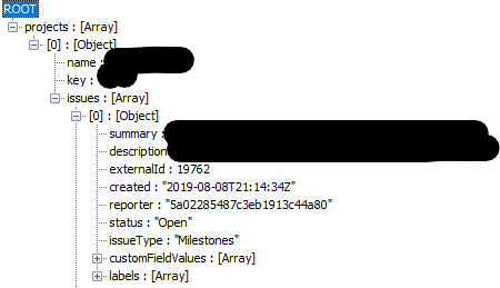

As you can see, first create the dictionary, then the data inside each object data.
At the end you will see the JSON object like:
Once the JSON object is built you can use the External System Import to push your data in Jira.
