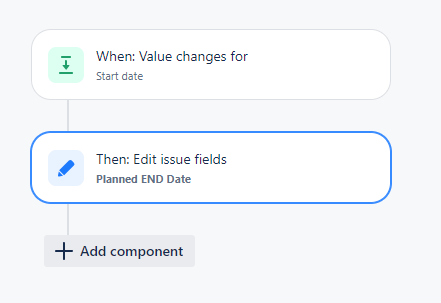

×I am trying to change the End Date using an automation starting from an existing field (set as Number instead of day).
I read that you should set the Number in Days in order to be calculated but it does not work.
i did 1 automation which are applied in 2 different transition in the workflow.
In the first automation which is working, I extracted the Number of days (Duration) ==>customfield in Number)
between the planned and the start date.
Now,
I want , with the 2nd automation, add this number to the end date starting from the previous value already set Planned END date.
The automation should be as follow :
When Value changes for StartDate
then
Edit Issues field : End Date as follows
{{issue.Planned END Date.plusDays(issue.Duration.asDays)}}

Thanks a lot but it does not work. the automation is as follows :
When : Value Changes for Start Date, Edit
End date and set the value as follows :
{{issue.Planned END Date.plusDays(issue.Duration)}}
is it possible that the mistake comes from the that end date is without value at the beginning?
I tried with another field to understand the issue ( a field with a date) and it happens that when i run the automation, the date which was previously set, disappears , how is it possible?

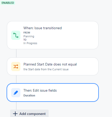

1st transition from Analysis to Planning, I put the PLanned Start Date & Planned End Date .
in the second transiiton that you see below , from Planning to In rpogress, i check between Planned Start Date and Start Date the delta days and the automation fills a custom field called Duration. It works. It provides me the Delta days between the 2 fields
smart value used :
{{issues.Planned Start Date.diff(issue.Start Date).days}}
The custom field duration comes out with a Number .
Second Request.

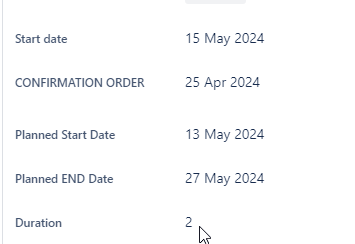

when i transition from planning to in Progress, in the screen I add the Start Date and i am asking to the automation to use the Duration field value (2 in this example) to be added to the initial plannned END Date .
smart value used as mentioned by you does not work so i tried this one below :

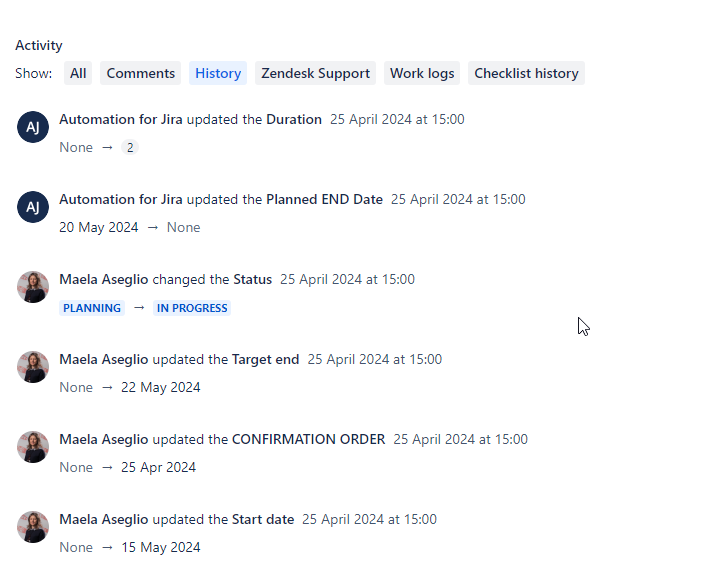

In this case, the value PLANNED END DATE disappeared completely

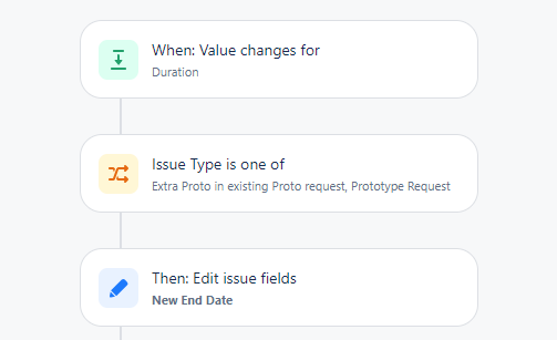

Update your trigger and use the Duration, so it will trigger when the Duration is already have a value. There is a chance that the 2automation is triggered at the same time where Duration dont have yet value.
Also Im confuse about the End date. base on the instruction earlier:
So you said edit Issue field is End Date not the Planned END Date. but base on your screenshot, you are updating the Planned END Date.
But nevermind, you just need to update the trigger Issue. then make sure that the automation is checked to allow other rule to trigger the automation
I changed as mentioned by you, triggering the action when the Duration field has a value and by changing the planned END date with END Date but it does not work .

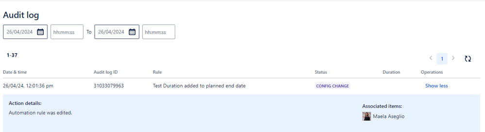

Like I said. use the trigger issue field Duration. If you can show us the auditlog maybe we can help you better.
Have you checked the automation is checked to allow other rule to trigger the automation. I cant see if the automation us successfully run or not.

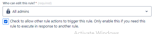

The screenshot i shared. There is a checkbox at the button of automation rule details. Where you need to checked so it allow other automation to trigger your 2nd automation.

I have updated and triggered the action based on Duration and not on start date but it is not working . the audit log mentions only Cong change without any action . If i use as trigger start date, it gives me success without adding any value in the plannned end date . I suppose that the duration which is expressed in number is not changing in days and for that reason it is not recognizing the field type
