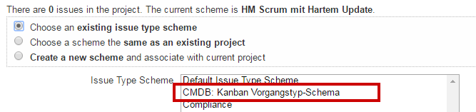

That is strange, you can just add one issue type scheme to your project, not two.
Adding an issue type scheme goes like that:
  • Open your project
  • Click on "Project Settings" in the grey left pane
  • Click on Issue Types:
  • Select "Use a different scheme" from the dropdown:
  • Select your new Issue Type Scheme:
  • issuetypes3.pngand click "OK" - that should do it

Good morning Thomas, sorry for the delay, I was using it incorrectly, I solve it. Thank you for your help.

Sorry, but you really can't avoid adding your issue type to the default scheme. Why do you need this default scheme?

I see, but that is not possible.
Every issue type you ever create in your jira instance will be added to the default issue type scheme.
The only solution is to not use the default issue type scheme.

no, you can't delete the default schema. It is always there and it has all issue types you create.
But you can create a new issue type scheme on your own that has only the types you want and then you have to assign this new issue type scheme to your project(s).
