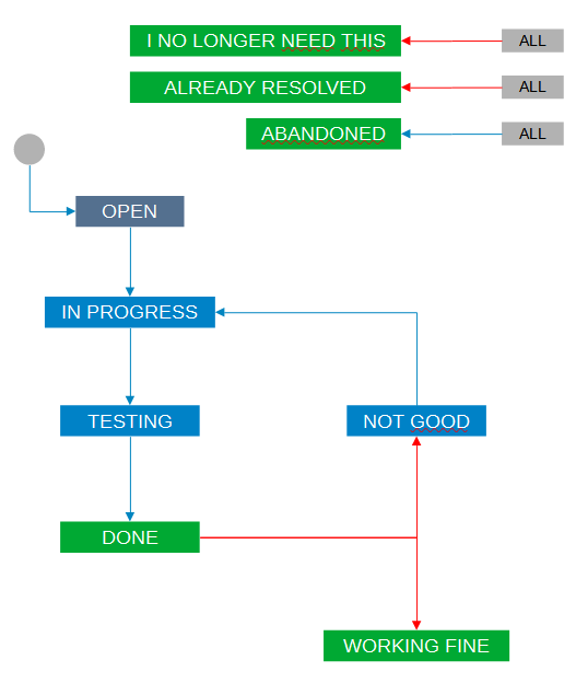

Iago Docando
October 30, 2020
Quick suggestion for what you might be trying to achieve, as far as I've understood (of course you'll have to use your actual statuses).
The blue transitions must have a condition that users in the group customers (for example) can't execute them. The red transitions mus have a condition that ONLY the users in that group can execute them.
I hope it helps.

akunnari
October 30, 2020
This is pretty much what I want, but the problem is, that our workers could transition from "in progress" to "working fine" inside our own ERP System. What the interface would have to do then is to know hwo these 2 status are connected, execute the statuschange from "in progress" to "testing" to "done" to "wokring fine" but there is already a catch. It would be a hella much work to define every possible transition chain we have in our company (we have like 25 internal staus' a ticket can have) and thats why I tried to create this solution.
What the customer should be able to do is to activate the transition "in testing" --> "Good/bad" which would internally go from "in testing" to "transition" to "good/bad" without the customer even noticing, that the ticket was ever in the "transition" state
Iago Docando
October 30, 2020
I believe you're overthinking it a bit :)
Instead of complicated automated routes A-B-C-D or A-B-C-E just create as many A-D or A-E transitions as you need, of course propprerly configuring any condition or postfunction.
I might be missing something from your explanation but in general I would advise you to not to create any status if your process doesn't take into account moving the issue to that status. I mean, either tell the user that he must update the status to "testing" when he's about to start testing or remove the status entirely and go directly from "in progress" to "working fine" once he's done testing (just an example, do what you  think suit best you actual process). In this second case you could use something like a custom screen to promt the user for info like testing start date / end date / actual time spent in testing between those dates... everything goes.
Of course jira (or whatever other tool) is just used to document and trace the processes we've previously designed, they aren't the processes themselves.
