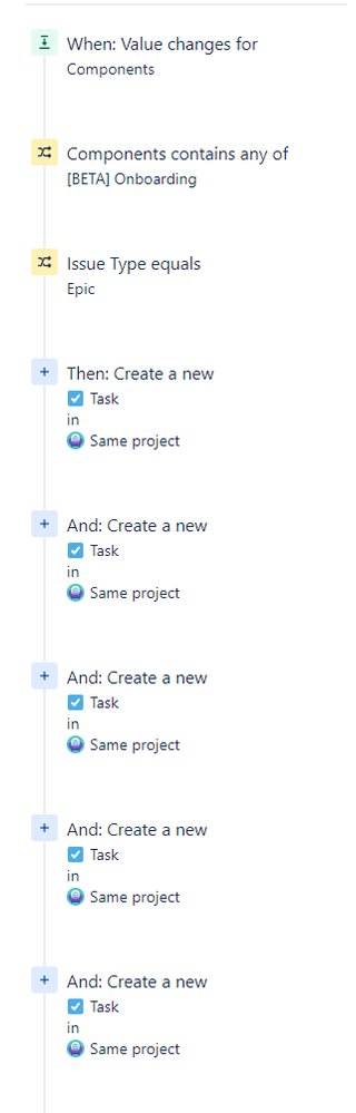

RULE 1 :
  • When an Epic is created, the rule 1 will create a serie of tasks with the EPIC as parent

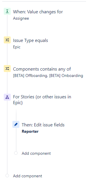

  • I have a set of subsequent rules that assigns tickets, copying the component from the EPIC to the tasks and other things like that.
  • All the subsequent rules have the "Allow rule trigger" checked
First, you may asked : why subsequent rules and not having those in the 1st rule? That's because the fields on which these rules are based are not mandatory. Plus, it was way more flexible in case the value of on the fields that triggers changes afterwards.
The thing is : it doesn't work.
  • If the fields are updated after the epic creation, everything works fine!
  • If all the fields necessary for the subsequent rules are added as epic creation, the subsequent rules triggers alright but shows : "Branch rule / related issues, No related issues could be found.". So it seems that Rule 1 is indeed trigerring subsequent rules but to early in the process and the tasks haven't been created at that time.

Hi @Antoine Claudé-Pénégry -- Welcome to the Atlassian Community!
If you want two rules to execute one after the other (i.e. you intend the first rule to complete before the second rule starts) try structuring the triggers to do that.
Your second rule is triggered on change to the Epic's assignee, which could certainly occur before the first rule completes.  In fact, the opposite could occur too, based on when the rules start!
I suggest pausing to:
  1. map out what problem you are trying to solve,
  2. decide the order of steps in your solution, and then
  3. build rules which will occur in that order.
One way to do step #3 is to identify the unique condition which confirms the order, such as adding a comment as a final step in the rule.  And, pay close attention if your rules contain any branches:
  • branches which can process one-and-only-one issue (e.g. on parent, last created issue, current issue, etc.) get run in-line
  • however branches which could process more than one issue (e.g. issues in Epic, JQL, etc.) run in parallel and asynchronously.  There is no guarantee they will finish before the next rule step, or even all the other rule steps.

Hi @Antoine Claudé-Pénégry ,
the issue might be because the first rule is executed in the background and does not finish before the next one starts. Have you tried adding the action "Re-fetch issue data" before the branch ?
Let me know if this helps,
--Alexis
August 26, 2022
It is probably that.
"Re-fetch issue data" is which rule? The first one and the subsequent ones?
