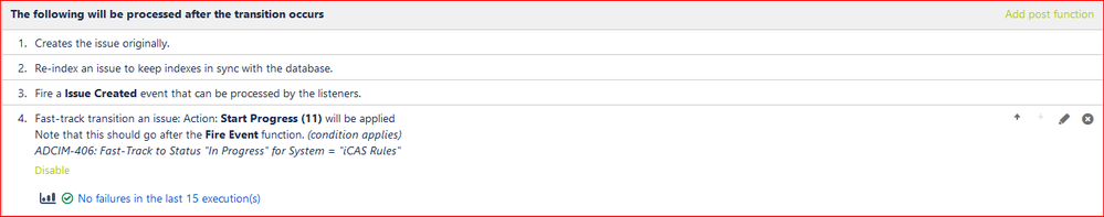

However, in certain circumstances the mentioned source Issue should travel through the above mentioned transition directly after creation (using a FastTrack-Transition-Postfunction in the Create-Transition). In that situation, accessing the linked issues of the source issue fails and returns an empty list of issues.
So it looks to me like the setting of the linked issues during the creation of the source issue and accessing the linked issues happens in the same internal transaction, therefore the linked issues are not yet available.
So how can I tell Jira to first completely create the source issues (including its links to other issues), before starting on the transition of that source issue?

You could try including the Listener for this requirement, i.e., a Custom Listener with the IssueCreated event.
So, once the Post-Function triggers the Fast-Track and the Issue is created, the Listener can be used to update the Issue and set the value for the Issue Picker.

c) FastTrack-Condition in the create-Transition of the second issue, connecting the code of a) and b) in one transaction
Triggering the approach is not 100% guaranteed to be successful when using the Post-Function for the Create transition, which is why I suggested including the Listener to ensure that it will trigger only after the issue has been created.
