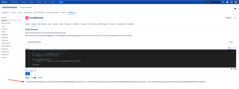

Below is a screenshot of the output returned:-
You will basically have to pass the List of encoding values returned into your JSON.

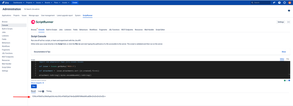

 Below is the screenshot from the ScriptRunner console:-
Also, I have run the test above using ScriptRunner's HAPI feature. I suggest upgrading your ScriptRunner plugin to the latest release, i.e. 7.13.0, to use the HAPI feature.
