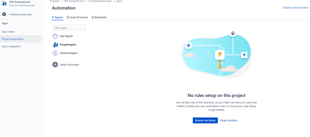

We didnt set a rule or a automatisation

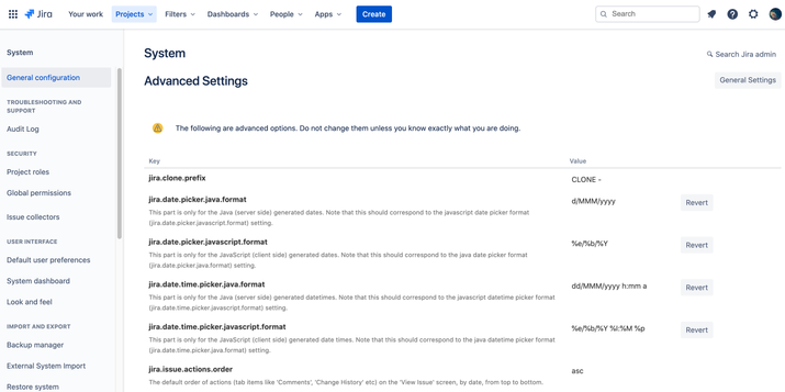

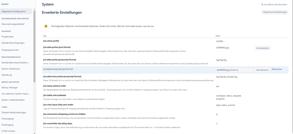

I have a hunch as to the cause here.  Could you please navigate within Jira into the System -> Advanaced settings page?  You can get there by going to the Cog icon -> System -> General Configuration -> then click the Advanced settings button OR navigate specifically to [yourSite].atlassian.net/secure/admin/AdvancedApplicationProperties.jspa
I am interested to see what values you have entered here for
  • jira.date.picker.java.format
  • jira.date.picker.javascript.format
  • jira.date.time.picker.java.format
  • jira.date.time.picker.javascript.format
Here is my own customized entries.  The only changes I made in my own was to use 4 digit year values everywhere.
What I suspect has happened here is that you might have selected a .java.format value in using a 'm' or 'mm' (minute) instead of an 'M', 'MM', or 'MMM' value (Month).  If I am correct, it could explain the behavior you have seen here.  Jira is attempting to interpret the date value you have selected, but because it's being told to look at this second number as a minute value, the month value isn't technically being set by Jira when you enter any date.  As such Jira is defaulting to a value of 1 because it needs to have some value here or dates just don't work at all.
Let me know what your values are on this page for those 4 fields, and I should be able to help you correct them so that dates will appear the way you want within Jira.

stiv_marro
January 24, 2021

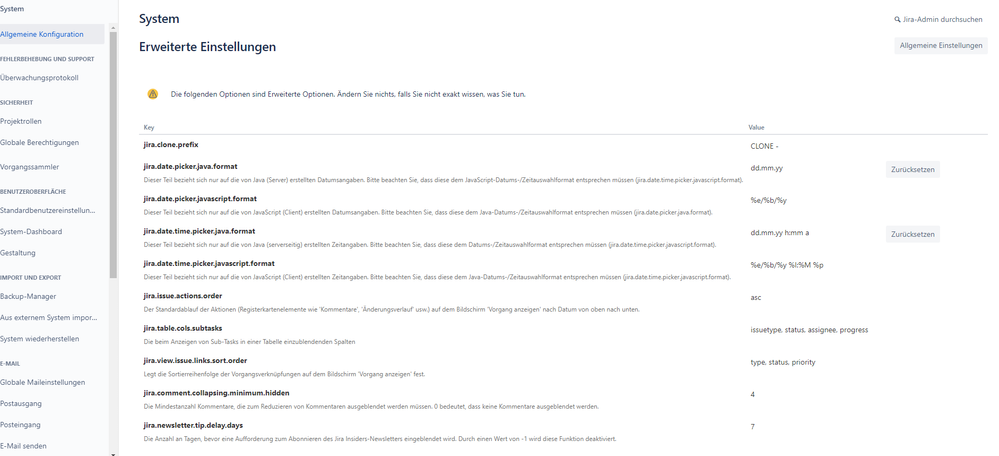

Hi Andy
Thanks for your Help.
Here is the screenshot of the advanced properties.
I changed them, equal your screenshot. You where absolutly right with your speculation.
Now it works fine!!
Many many thanks to all for solving my problem!

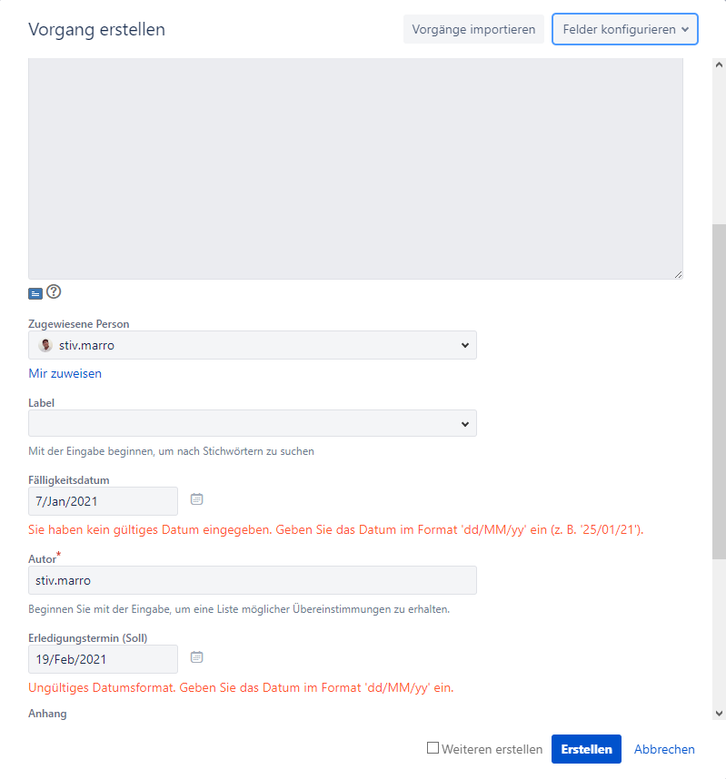

But i would be very glad if you can set all dates correctly for me. Date Format dd.MM.YY
Because if i open a new task and try to take a date from the picker, it doesn't work. I have to put it manually. Changing dates in the picker from a existing task, works fine!
First settings
settings new after your correction
stiv_marro
January 24, 2021
Hi Andy
Now it works very fine with this settings.
Many thanks for your help in my case.
I changed the settings equal your screenshot.

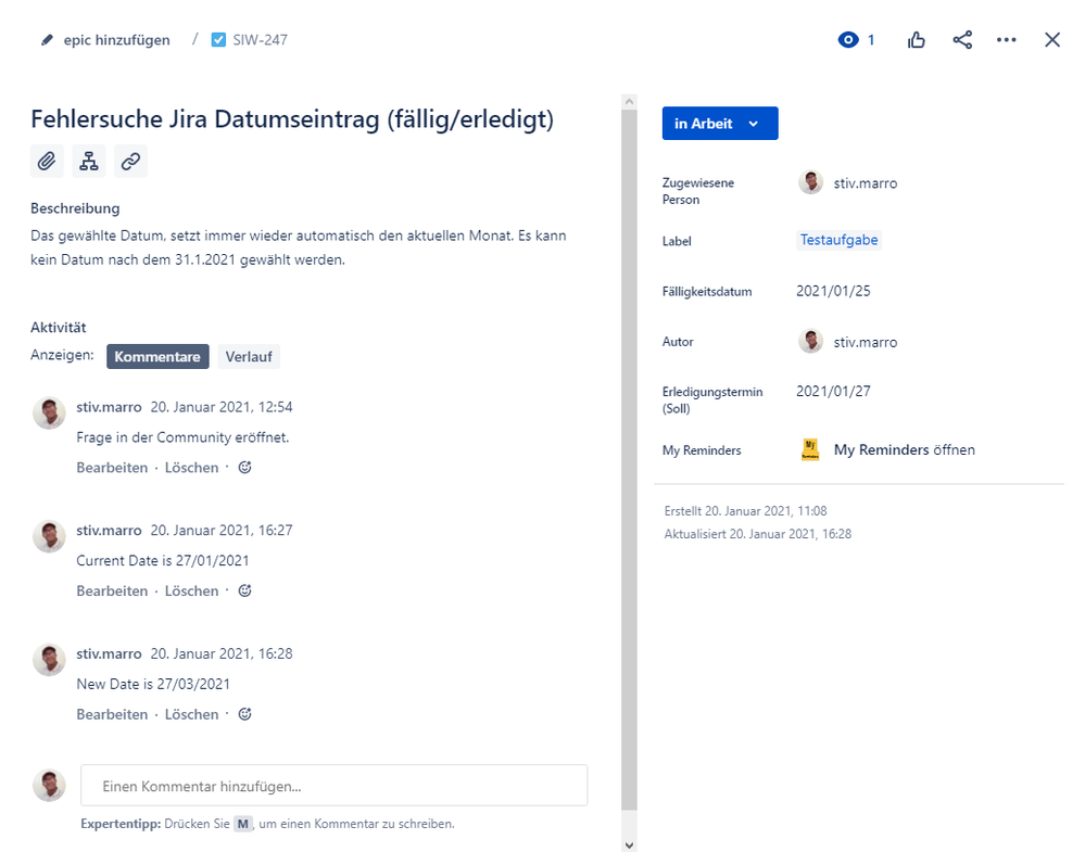

Hi

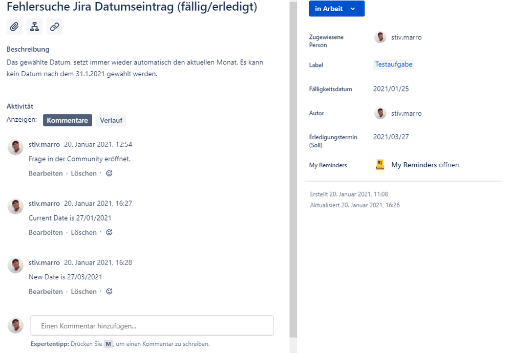

the screen capture show the problem happening using the date picker widget. The field seems to change on the page but gets reset.
stiv_marro
January 24, 2021
Hi Tom.
I also tried to set the date manually.
No chance!

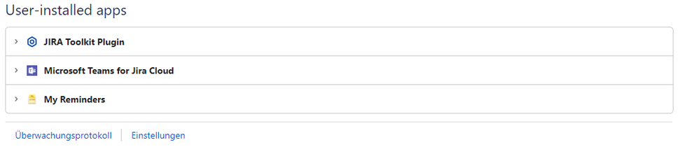

stiv_marro
January 21, 2021
Hi Tom
Here is the List of installed apps. As i can see, this installed ones, are normal plugins from Atlassian
Dirk Ronsmans
January 21, 2021
Based on those I can't see what would interact with the issue in this way..

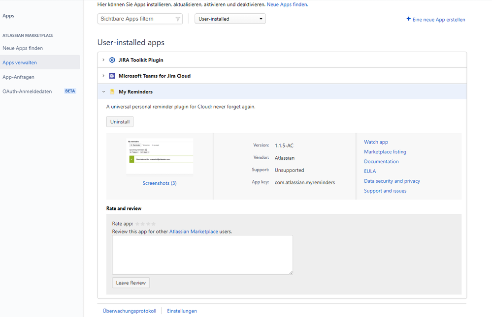

You can try disabling "my reminders" for a moment as that does some Date stuff but I cant see why it would change your dates.
//starting to lose my mind on this one..
stiv_marro
January 21, 2021
Hi Dirk
i will give this one a try.
But i  don't see any function for "disabling" the plugin. i have only the option to uninstall? i think, that this would effect the productiv work to much.
Please don't loose your mind! I'm thankfull and happy about every help that i can get from you.
Best wishes
Stiv
Dirk Ronsmans
January 21, 2021
Ah yes, Cloud only has "Uninstall", this should not affect the data tho (it should even mention it when you click the button that your data is kept for some time).

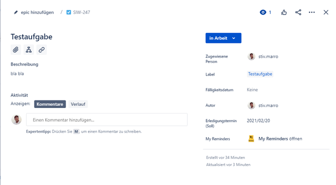

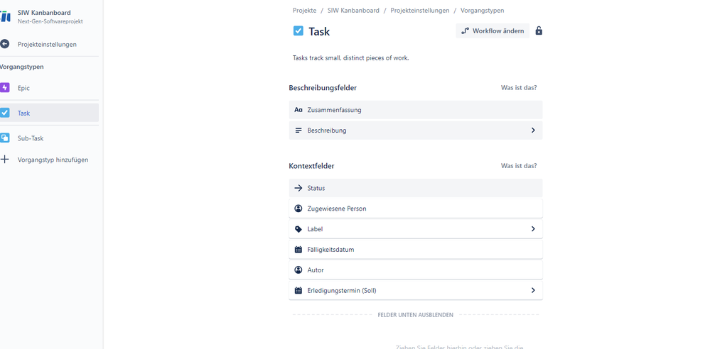

Hi @stiv_marro , welcome to the Community. This seems very wrong. To be clear you have a date field and when you select a date it registers in the field but you then reload the page and the dat has changed. Further it seems you are saying that the behavior depend on the actual date selected, I.e. a date beyond Jan 31. Is this correct? If automation or some sort of background action is not happening then sure seems like a bug. But TBH I’m not yet there. Can you perform further testing to zero in on the behavior? What about other date fields? Different dates?
stiv_marro
January 20, 2021
Hi Jack
Thanks for your reply
Yes you're right. I have tested all the date fields. I'ts impossible to set a date after 31.1.2021!
We just have this 2 date fields: Expiry date and finishing date.

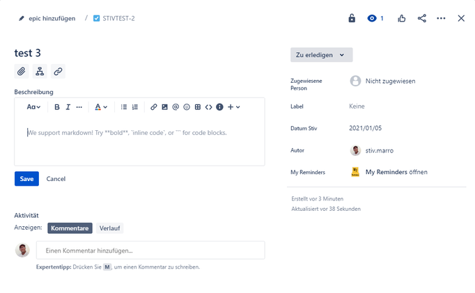

I just created a new project and testet the same case.
I put a datefield in my task.
After i picked a date from the datepicker it registers the date right.
When i reopen the task again, the date jumped back to the actual month.
Same error in the new project
Best wishes

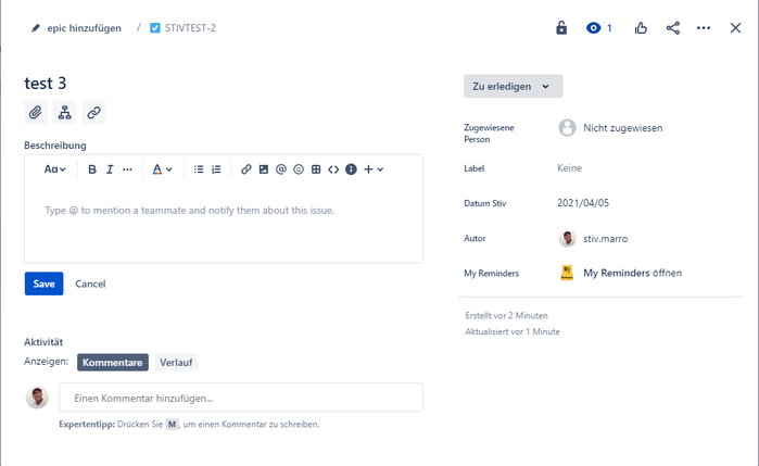

Jack Brickey
January 20, 2021
first I have removed the "Answer accepted" as I don't think you have your answer yet. you should reserve clicking that until you feel you have the final answer.
I'm scratching my head. Based on your image above it seems that you have YYYY/MM/DD format and you enter 2021/04/05 (April 5th, 2021) and then you reload the page and your date converts to 2021/01/05 (Jan 5th, 2021). If this is the case that is totally bizarre to me. If you were not on Free I would point you to support but that is not an option. Let me reach out to others to chime in here.

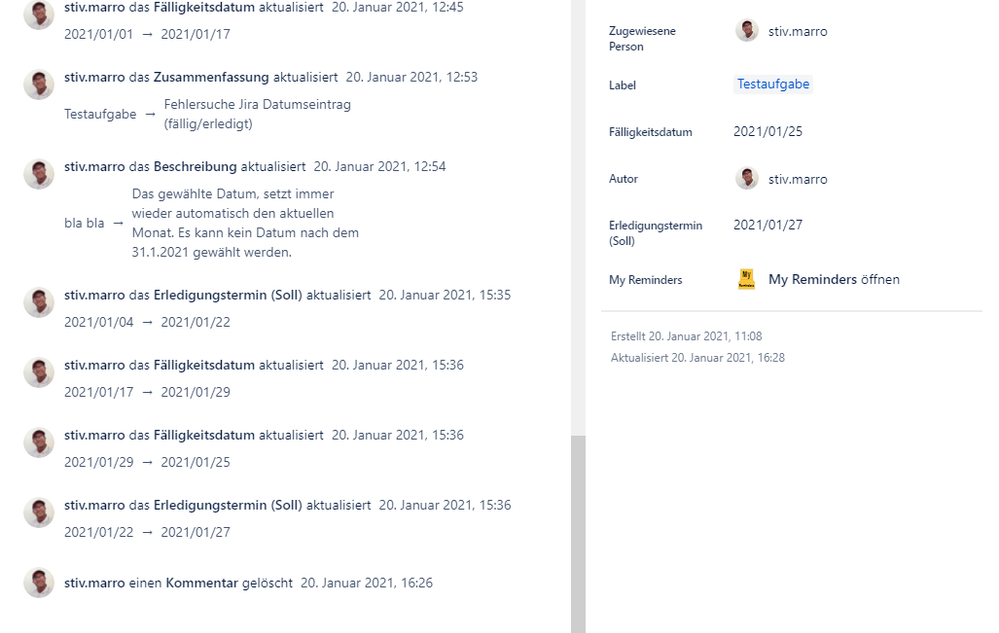

Jack Brickey
January 20, 2021
can you inspect the history tab on the issue and share what you find there?
stiv_marro
January 20, 2021
Hi Jack
Shure, have a look.
Jira made a history for all reactions in modifying the date.
But the history only shows the "switched back" date.
best wishes

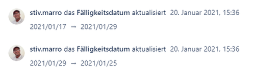

Dirk Ronsmans
January 20, 2021
I guess the issue then is this?
The strange part is that the field is adjusted on the same second and by a user. So that leads me to an automation that runs under the user who triggered it.
Are you sure there are no automation rules that are calculating a new date?
Jack Brickey
January 20, 2021
confusing. if I look at your previous images you show a date of 2021/04/05 but do not see that in the history. So if this is indeed the same issue they your changes are not being saved. when you change a date do you then click outside of the date field? If not the change is not saved. In other words if I simply click in a date field and select a date from the calendar and, leaving the cursor in the date field, simply refresh the page then the date will revert. in short are you sure you are registering the date change?
Test:
  • refresh the page and observe the date
  • enter a comment - "current date is yyyy/mm/dd
  • click into the date field and change the date
  • click out of the date field and observe the date
  • enter a comment - "new date is yyy/mm/dd"
  • refresh page
  • view results and send history screenshot if still observing broken behavior
Like # people like this
stiv_marro
January 20, 2021
Hi guys
I tried your steps and saw, that my last changes didn't get tracked by the history:
