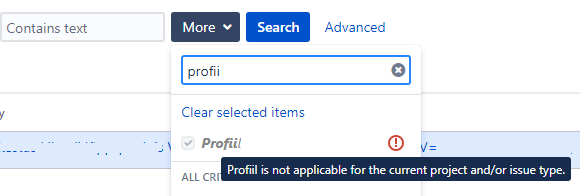

How i can use custom field in Jira DC search when right now i get error - customfield is not applicable for the current project and/or issue type.
I read that if it is not available in project then it will not work but right now this field is in every use in issue type and in project where i like to get values.

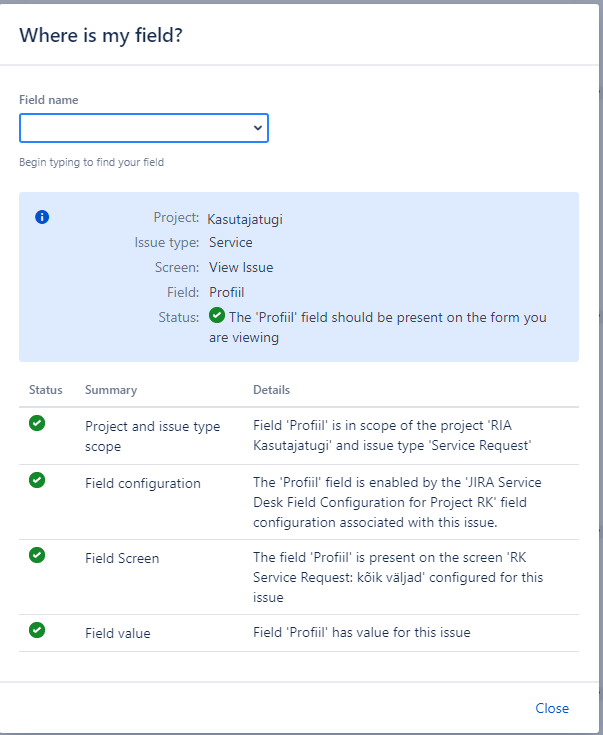

I add some images. i hope that this is what helps to solve my problem.

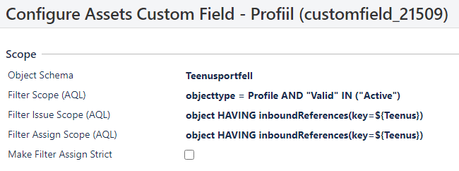

There is some AQL behind:
It takes values from Jira Asset. In Asset there is one object Profile where all values is written down. Then there is another object Teenus where is selected needed Profile values into Profiil Customfield.

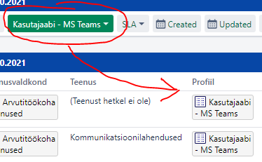

I have created Dashboard with Rich Filters for Jira Dashboards and into there i can add this option
With that i can filter out tickets where this Profiil value is filled. Not all tickets have Profiil value filled.
