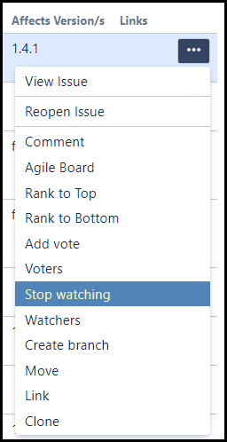

When toggling Stop / Start watching this issue on the issue page did not work, I successfully stopped watching issues by toggling Stop watching / Watch issue from the filter results page:
