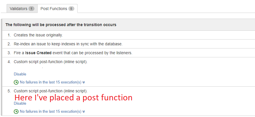

zaharovvv_suek_ru
July 10, 2018
Thank you very much for all of your efforts, guys!
Finally it has started to work!
It turns out that it was necessary to move  post function to  the last place after all steps:

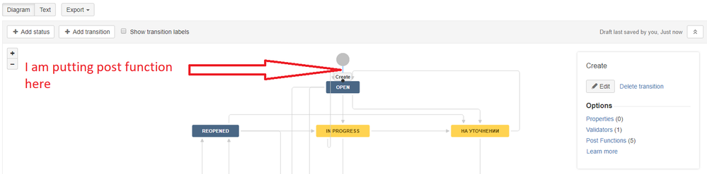

zaharovvv_suek_ru
July 4, 2018
Yeah, after issue created. I can read name of newly created issue, however cannot read inward or outward links.
The image where I put post -function:Workflow and its post function with  arrow and text.png
